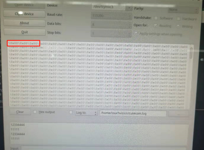

您好:
  在使用uart1-uart4时,发现的问题是串口只能发送数据i.MX8MQ不能收到从外部发来的数据。
设备树中:please remove "fsl,uart-has-rtscts;" in your device tree uart setting,也是一样的情况,不能收到数据。
开机时log:
[ 0.000000] Kernel command line: console=ttymxc0,115200 root=/dev/mmcblk0p2 rootwait rw
[ 0.316953] 30860000.serial: ttymxc0 at MMIO 0x30860000 (irq = 26, base_baud = 1562500) is a IMX
[ 1.264293] printk: console [ttymxc0] enabled
[ 1.269218] 30880000.serial: ttymxc2 at MMIO 0x30880000 (irq = 27, base_baud = 1562500) is a IMX
[ 1.278552] 30890000.serial: ttymxc1 at MMIO 0x30890000 (irq = 28, base_baud = 1562500) is a IMX
[ 1.287901] 30a60000.serial: ttymxc3 at MMIO 0x30a60000 (irq = 35, base_baud = 1562500) is a IMX
板:i.MX8MQ
内核版本:L5.4.47
系统:ubuntu16.04.7

打印输出:./a.out -d /dev/ttymxc3 -b 115200 -s 123
/dev/ttymxc3 RECV 512 total
/dev/ttymxc3 RECV:
/dev/ttymxc3 RECV:
/dev/ttymxc3 RECV:
/dev/ttymxc3 RECV:
/dev/ttymxc3 RECV:
/dev/ttymxc3 RECV:
/dev/ttymxc3 RECV:
/dev/ttymxc3 RECV:

lebeer
imx8mq recv:all 0x00
