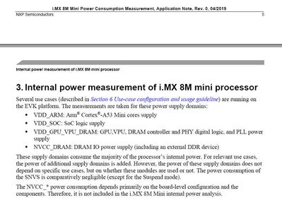

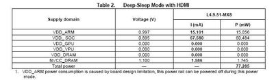

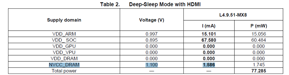

      I had checked AN12118.pdf(i.MX 8M Quad Power Consumption Measurement) before,  but 1.585mA does not include external LPDDR4 core current. I need find a way to let LPDDR4 to enter "Power Down Self refresh" mode. Which kernel code is responsible for this? We need change register PWRCTL, right? On mx7, it has this kind of code to do suspend in kernel, but not find for mx8m.pastedImage_1.png

7,331 次查看
ponomarev_ke
@igorpadykov
For our experiments, we use i.MX 8M Mini LPDDR4 EVK Board with imx-yocto-L5.4.24_2.1.0 release. UPD: we also tried to use mx-yocto-L5.4.70_2.3.0 release, result is the same.
We have desoldered all unnecessary components from processor board and baseboard, thus on processor board remains only CPU, LPDDR4 and PMIC. We can't add sense resistors to processor board according to the "i.MX 8M Mini Power Consumption Measurement" document, because there is no space.
When we put processor to the Suspend mode (echo mem > /sys/power/state), we see that VDD_ARM and VDD_GPU_VPU_DRAM voltages become 0V, this is consistent with clause 4.1.1 in the "i.MX 8M Mini Power Consumption Measurement" document, but the power consumption remains high (350mW as I wrote before).
I attached dmesg dump file. In the dump we find tha there is no messages about CPU0 shutdown, only about CPU1,2,3.
So now we have two ideas why power consumption in suspend mode is so high:
1) CPU0 doesn't transfer to suspend mode (doesn't shutdown according to dmesg dump)
2) LPDDR4 doesn't transfer to self-refresh mode
We found that "Power State Coordination Interface" (PSCI) in ATF is risponsible for power management features. There are functions "imx_domain_xxx" in imx-atf/plat/imx/imx8m/imx8m_psci_common.c which are responsible for transfering processor to suspend mode. Is it correct?
Also we found, that for example, for imx8mq processors functions "imx_domain_xxx" are reimplemented in file imx8mq_psci.c. Does it mean that for imx8m mini processors correct transfer to suspend mode are not implemented yet,  and we should it implement it by ourselves?
We think that LPDDR doesn't transfer to self-refresh mode because ATF code (specifically bl31.bin) located in LPDDR, not int OCRAM. Is it correct? Can you provide any information about that?
Konstantin Ponomarev

7,838 次查看
igorpadykov
Hi Wit
one can check sect.4.1.1. Deep-Sleep Mode (DSM)  AN12118
https://www.nxp.com/docs/en/nxp/application-notes/AN12118.pdf
test with Demo Images from i.MX Software | NXP
Sources are described in sect.2.5 Power Management Linux Manual
in Linux L4.14.98_2.0.0 Documentation
igor
