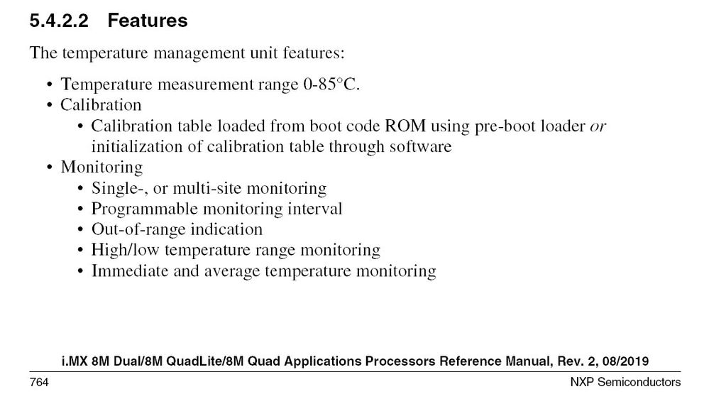

igorpadykov
Hi Nirmal
regarding" i.MX8MQ TMU is not able to read negative temperature",
as stated in sect.5.4.2.2 Features i.MX8MQ Reference Manual:
"Temperature measurement range 0-85°C."
igor

nirmalluhana
Hello Igor,
Thanks for your response.
We observed that i.MX8MQ TMU is not able to read negative temperature values and gives the error of invalid sensor data after enabling the debug prints in arch/arm/mach-imx/cpu.c file. Hence, our board is failed to boot at the temperature below 0C.
If we disabled CONFIG_NXP_TMU macro in the defconfig file then we are able to boot the board below 0C as it is not going to check CPU die temperature.
Can you please provide more information due to which reason we stuck at u-boot as mentioned in above logs when CONFIG_NXP_TMU macro is enabled as there is no blocker available in the code?
To read CPU die negative temperature we required the patch and we also generated the ticket on the link which you provided. But still, we don't get any patch related that.
Nirmal
5,215件の閲覧回数
igorpadykov
Hi Nirmal
igor
