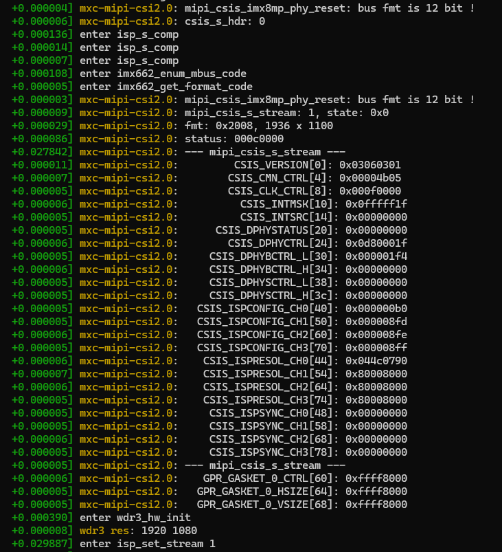

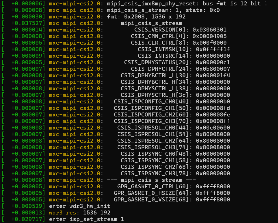

I ran some tests with a sensor had already kernel driver and my sensor under development. So I used this commands to try some debug logs using dmesg in terminal:
$ sudo echo 2 > /sys/module/imx8_mipi_csi2_sam/parameters/debug
$ sudo echo 'file v4l2-fwnode.c +p' > /sys/kernel/debug/dynamic_debug/control
I observed in logs that the bit STOPSTATECLK in MIPI_CSIx_DPHY_STATUS resgister stey always in 1 when I load the driver and start the tests app as showed in print. The value is always C1 and nothing is captured.
Do you know other method to monitoring dynamically the register of interest (devmem maybe)?
My sensor
Reference sensor.
タグ(1)

joanxie
if STOPSTATECLK  alwayas 1, you need confirm if your camera side set correct or not, could you get the signal from camera side or not, then ensure camera enter LP before enable the mipi dphy
