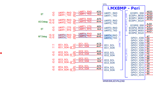

I'm designing a customer's board using i.MX8MP
And I noticed that on IMX8MP-EVK respectively using
- UART2 for A53 debug output (KERNEL)
- UART4 for M7 debug output
Under what circumstances will the M7 debug port be used?
Does the M7 debug port need to be retained?
2,162件の閲覧回数
Chavira
Hi @petertseng!
Thank you for contacting NXP Support!
We reserve the uart4 for M core debug in case you are using that core, but you can use the uart4 on A core.

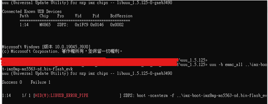

I'm using the LF6.1.22-2.0.0 imx manifest.
https://community.nxp.com/t5/i-MX-Processors/IMX8MP-uart2-to-uart4/td-p/1616936
I have added all the patches based on the above article.
But when I try to use UUU to burn the sd.bin-flash_evk file I get the following error.
Best Regards
Peter
2,110件の閲覧回数
Chavira
Hi @petertseng!
What board are you using?
Try to see if your board is connected correctly using the command "uuu -lsusb"
The patches of the post that you are referring to are to change the UART2 for UART4 to console debug for A core.
To add the UART4 to be used in Linux you have to refer to the post that I mentioned before.
To burn only the imx-boot image you have to use the next command:
uuu -b emmc imx-boot.bin
To burn the imx-boot image and the rootfs you have to use the next command:
uuu -b emmc_all imx-boot.bin imx-image.wic
If you are using Linux try with sudo and if you are using Windows open the PowerShell with administrator permissions
Best Regards!
Chavira
2,101件の閲覧回数
petertseng
Hi Chavira,
Thanks for your reply!
Since the customer's PCB is still being designed, I can only use 8MPLUS-BB EVK for verification.
I previously referred to TARGET_IMX8MP_DDR4_EVK to create a customer's module.
But it seems that you can only use TARGET_IMX8MP_EVK (LPDDR4) to verify on EVK.
Now I can burn images to EVK, and UART4 also works fine
Best Regards
