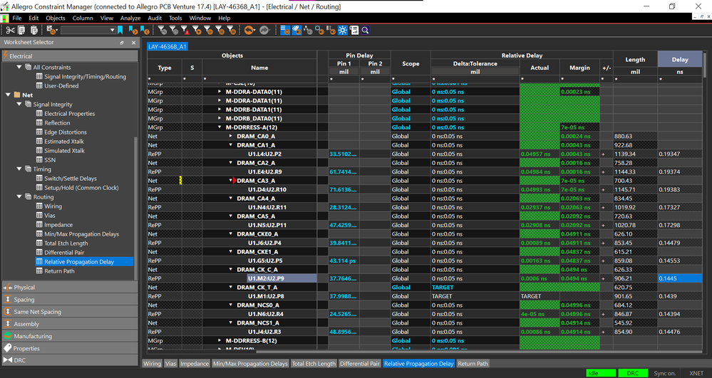

One thing to note is that comparing to the IMX8MP-EVK we connected the CA and CB to their respective pins on the CPU (in the EVK they were reversed)
Here are the respective lanes lengths and the delay deltas
スポイラ
1. CAx_B, CKE_A, CK_CS_A - 20mm, <1ps
2. CAx_B, CKE_B, CK_CS_B - 19mm, <1ps
3. DQ07_A - 15mm, <1ps
4. DQ07_B - 14.5mm, <1ps
5. DQ815_A -10mm, <1ps
6. DQ815_B -10mm, <1ps
7. CKA - 21mm, DQS0 - 15mm (-22ps to CKA), DQS1 - 13mm (-55ps to CKA)
8. CKB - 21mm, DQS2 - 14mm (-24ps to CKA), DQS3 - 13mm (-54ps to CKA)
Can the CA/CB swap be the reason of the problem?

When laying out the LpDDR lines, we used the same rules as before when laying out iMX8MM, without paying attention to the tightening of the requirements for the CAx lines (within 2 ps in groups), and did not take into account the Pkg delay. So, two questions.
1. Is it possible to configure the CA_x_y lines and run the board with a spread of CA lines times of about 20 ps (possibly at a slow speed), or it is impossible to do without redesigning the board?
2. In the i.MX 8M Plus Hardware Developer’s Guide, all timings seems like in EVK. But the delay on the CK_A lines is indicated to be about 107 ps (145 ps taking into account the Pkg delay). On the EVK board (directly in the project that you provided), I see a delay on the CKa lines of about 89 ps (127 ps taking into account the Pkg delay, and this is outside the 50 ps tolerance for the CA_A_0...4 lines). What is correct?

127 + 50 ps < 191ps
964件の閲覧回数
JorgeCas
According to constraint manager, the routing is under the recommended values:
Best regards.

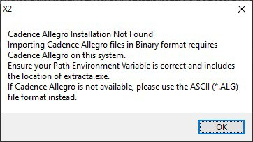

2. Our CAD does not allow importing the EVK pcb file in the format it is posted on your site. Can you provide it in ASCII format?
