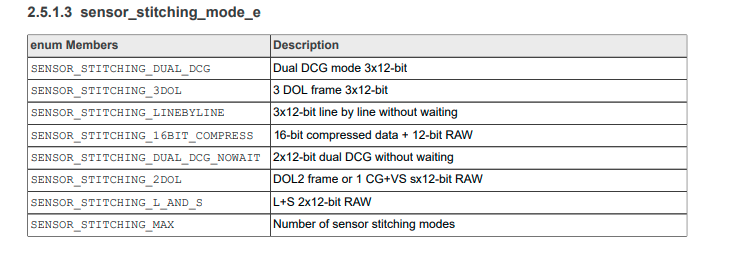

Dhruvit
Hi @artsiomstaliaro,
Customers have to set vvcam_mode_info_s based on the output format supported in the custom camera.
One can set the stitching mode from the below table.
Please make sure that you have configured other settings correctly as shown in 2.6.2.2 Create Sensor V4L2 Driver in VVCAM in i.MX 8M Plus Camera and Display Guide
Please make sure that sensor registers are configured correctly for HDR mode.
Please refer to /vvcam/v4l2/sensor/ov2775/ov2775_mipi_v3.c in isp-vvcam where settings for ov2775 sensor are given.
