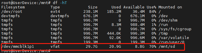

I now use the i.MX8MM EVK, the file system is ext4, and mount a 32G sdcard to the /mnt/sd path.
When I copy a 6G file size to the /mnt/sd path, I can only copy 4G size. Errors are reported as follows:
cp: error writing 'test_file': File too large
How can I modify the file system to support a single file larger than 4G?
1,351 Views
b36401
Please note that FAT does not support 4GB or more files. Maximum file size on FAT partition is 4294967295 bytes (4GB-1).
By the way you can make ext4 on the flash as well to be able to store big files.

Thank you for your reply.
I got it . This problem has been solved.
