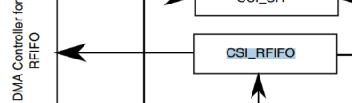

For debugging purpose, we are trying to read the CSI RXFIFO 'manually', from code placed in mx6c_capture.c. We know the DMA is no longer running and there is data in the RXFIFO as DDRY is set.
The problem is the calls to csi_read() at address CSI_RFIFO return the same two 32bit values (which are valid), and the DDRY flag is never reset, even though the camera is no longer sending any data. So we are not emptying the FIFO.
CSI_RFIFO = Address: 32E2_0000h base + 10h offset = 32E2_0010h.
So it looks as if CSI_RFIFO is cached, or somehow we cannot empty the FIFO from the CPU. None of which make sense, nor match the Ref Manual, page 3992.
Questions:
* Why can't we read CSI_RFIFO from CPU?
* How can we read the content of the RXFIFO from CPU?
* Is there an undocumented register to know what the FIFO level is?
We have placed the code to read in function mx6s_csi_irq_handler() at a point where we know the DMA is no longer reading from the FIFO.

Zhiming_Liu
Hi @vincentz63
Normally, we can dump CSI registers from Linux userspace.These registers are defined in CSI IP SPEC, not in Reference Manual.
The CSI_RFIFO will only input DMA Contronller, i think you can't read FIFO if you halt DMA.

Zhiming_Liu
What is the document your refer to? I do not seem to have it, where is it?
-->We can't send it to customer.
 RFIFO LEVEL register
-->OFFSET: 8h, BIT[6:4]
000 4 Double words
001 8 Double words
010 16 Double words
011 24 Double words
100 32 Double words
101 48 Double words
110 64 Double words
111 96 Double words
Are you saying that only the DMA engine can read this register and that the CPU cannot?
-->You must read FIFO via DMA engine.CPU can't read it directly if you halt DMA. There is no direct connection between CPU and this register.
