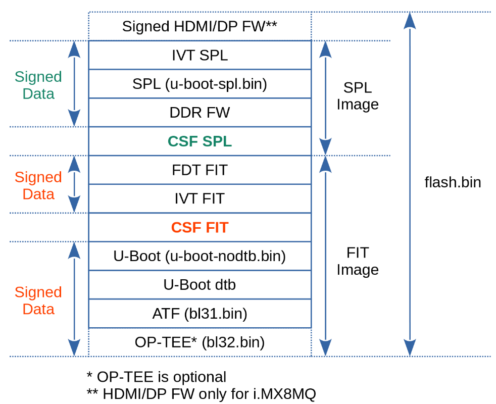

Hi guys,
Regarding the HAB on i.MX8M.
I know that i.MX6 HAB does not check the validity of the certificate. -> good for my project.
What is about the i.MX8 Series or specially the i.MX8M. Is there a validity check for the certificate?
Thanks in advanced!
And may I ask here...
Are there any hints for setup FIT + pubkey in uboot.dtb with the "new" u-boot layout.
So fare I'm able to do the u-boot verification with HAB and it works fine.
u-boot=> hab_status
Secure boot disabled
HAB Configuration: 0xf0, HAB State: 0x66
No HAB Events Found!
u-boot=>
as well I'm able to sign the FIT image with the mkimage. the local check for the signature the FIT image is working as well.

Problem is now if I create the flash.bin including the pubkey in the u-boot.dtb. I guess in this step I do something wrong. On the target the u-boot is not able to find the key to verify the signed FIT image. (dtb name removed because of policy)
u-boot=> ext2load mmc 2:1 0x50480000 image_signed_yocto_portkey_rsa.fit
8980546 bytes read in 140 ms (61.2 MiB/s)
u-boot=> bootm 0x50480000
## Loading kernel from FIT Image at 50480000 ...
Using 'conf@freescale_fsl-imx8mm-x-x-x.dtb' configuration
Verifying Hash Integrity ... sha1,rsa2048:portkey- Failed to verify required signature 'key-portkey'
Bad Data Hash
ERROR: can't get kernel image!
I'm working with the doc files from u-boot.
 doc/imx/habv4/guides/mx8m_mx8mm_secure_boot.txt
doc/uImage.FIT/signature.txt
doc/uImage.FIT/beaglebone_vboot.txt
unfortunately I was not able to get it work as it should...
Would be great if someone has a Hint here.

after I was able to sign the u-boot and verify the signature with hab_status,
I have now the problem, that I can not reproduce it again. unfortunately I have HAB Events all the time...
No matter what I do... always the same HAB events. I've tried with OPTEE and without....
Maybe you can give me some HINT what is wrong with the config CSF.

here CSF config:
FIT:
[Header]
Version = 4.3
Hash Algorithm = sha256
Engine = CAAM
Engine Configuration = 0
Certificate Format = X509
Signature Format = CMS
[Install SRK]
# Index of the key location in the SRK table to be installed
File = "/workspace/yocto-builder-warrior/meta-port/tools/cst-3.3.0/release/crts/SRK_1_2_3_4_table.bin"
Source index = 0
[Install CSFK]
# Key used to authenticate the CSF data
File = "/workspace/yocto-builder-warrior/meta-port/tools/cst-3.3.0/release/crts/CSF1_1_sha256_2048_65537_v3_usr_crt.pem"
[Authenticate CSF]
[Install Key]
# Key slot index used to authenticate the key to be installed
Verification index = 0
# Target key slot in HAB key store where key will be installed
Target index = 2
# Key to install
File = "/workspace/yocto-builder-warrior/meta-port/tools/cst-3.3.0/release/crts/IMG1_1_sha256_2048_65537_v3_usr_crt.pem"
[Authenticate Data]
# Key slot index used to authenticate the image data
Verification index = 2
# Authenticate Start Address, Offset, Length and file
Blocks = 0x401fcdc0 0x60000 0x1020 "flash.bin", \
0x40200000 0x5AC00 0x9BFD0 "flash.bin", \
0x4029BFD0 0xF6BD0 0x8232 "flash.bin", \
0x920000 0xFEE04 0xA170 "flash.bin"
SPL
[Header]
Version = 4.3
Engine = CAAM
[Install SRK]
Source index = 0
[Install CSFK]
[Authenticate CSF]
[Unlock]
# Leave Job Ring and DECO master ID registers Unlocked
Engine = CAAM
Features = MID
[Install Key]
Target index = 2
# Key to install
File = "/home/linderth/workspace/yocto-builder-warrior/meta-port/tools/cst-3.3.0/release/crts/IMG1_1_sha256_2048_65537_v3_usr_crt.pem"
[Authenticate Data]
Blocks = 0x7e1fc0 0x1000 0x2ca00 "flash.bin" # spi nor
#Blocks = 0x7e0fc0 0x0 0x2ca00 "flash_sd.bin" # sd card

Was there a solution to this? I am seeing the exact same errors. Everything is signed but I get
--------- HAB Event 1 -----------------
event data:
0xdb 0x00 0x14 0x43 0x33 0x0c 0xa0 0x00
0x00 0x00 0x00 0x00 0x40 0x1f 0xdd 0xc0
0x00 0x00 0x00 0x20

tanner_oakes
Double check all of your addresses. I had one wrong and that was what was causing the issue.
