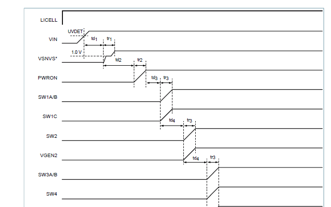

I have a question about the i.MX8M power-up sequence.In the spec “IMX8MDQLQCEC” on  page 25,it said "Turn on... VDD_DRAM",then "Turn on NVCC_XXX and NVCC_DRAM".When I researched the IMX8M demo design"MCIMX8M-EVK",I have found "VDD_DRAM" is connected to the pin SW3A/B of PMIC(MC34PF4210A1ES),"NVCC_DRAM" is connected to the pin SW2,according to the PMIC spec"PF4210" on page 17,I can see SW2 is powered before SW3A/B,so in the EVK design NVCC_DRAM is powered before VDD_DRAM?That does not match with the description in the spec “IMX8MDQLQCEC”,I cannot understand.

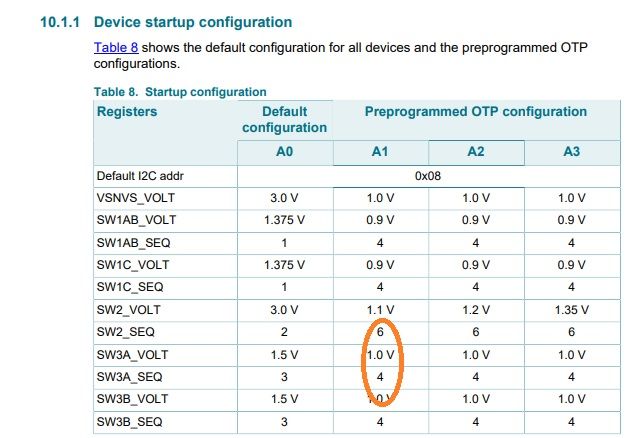

   PMIC MC34PF4210A1ES is used on the i.MX8M EVK. For the A1 case, according to
Table 8 (Startup configuration) SW2_SEQ is 6 and SW3_SEQ  is 4. That is, "VDD_DRAM",
connected to SW3A/B,starts earler than "NVCC_DRAM", connected to SW2.
