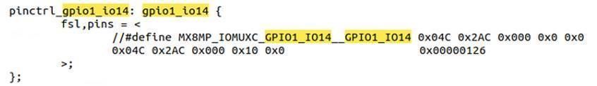

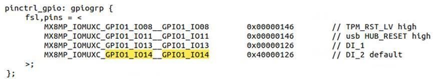

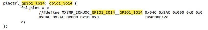

We have a custom I.MX8M plus board and need to config GPIO1_IO13 and GPIO1_IO14 to input. We can read value changing on GPIO1_IO13 but not on GPIO1_IO14. We also verify on EVK and it is the same.
We try to set SION bit of GPIO1_IO14 by memtool but it shows bus error. So we try to set SION bit of GPIO1_IO14 in uboot by "mw 0x3033004C 0x10" and check io value by "gpio status -a" and then it works.
Now we need to config dts in kernel. I have tried to config like below. All of the them do not work. I can only read 0 on GPIO1_IO14.
first I try:
second:
third:
1. Could you show me how to config dts of GPIO1_IO14 for input?
2. I can read GPIO1_IO13 value changing but not GPIO1_IO14 even the dts configs of both are the same. How to know which IO I need to set SION bit or else?

refer to the dts file, GPIO1_IO14 is already defined as below
pinctrl_usb1_vbus: usb1grp {
		fsl,pins = <
			MX8MP_IOMUXC_GPIO1_IO14__GPIO1_IO14	0x19
if you want to set one gpio as input, you can set it 0x1C4, but you need confirm if your HW design firstly

sophiehu
Hi Joanxie,
Thank you, it works.
BTW, we also config GPIO1_IO13 to gpio input. Why doesn't GPIO1_IO13 need to set the bit and work? How do I know if I need to set SION or HSY bit when config IO to input?

sophiehu
I mean, GPIO1_IO13 can work with dts 0x126 or 0x106. Why GPIO1_IO14 cannot and need to set to 0x1C4? How do I know if I need to set to 0x1C4 for other GPIO?
2,008 Views
joanxie
0x126 should be output, pls double check it, if you want to set GPIO as input, you need check bit7, set bit7 as 1 for input
