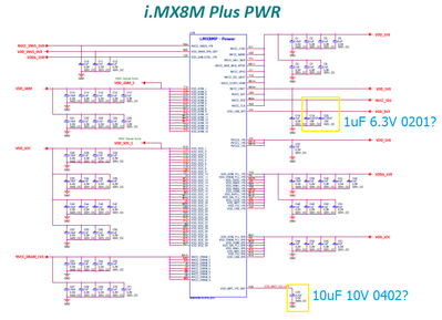

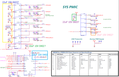

Hello, is it possible to make the changes at the images in the square windows on our custom board for production and purchasing purposes?
  • 1uF 6.3V instead of 0.22uF 10V
  • 10 uF 10V instead of 4.7uF 6.3V
  • 22uF 10V instead of 10uF 16V
  • 10uF 10V instead of 1uF 10V and 4.7uF 10V
  • 10 uF 10V instead of 4.7uF 10V and 6.3V
