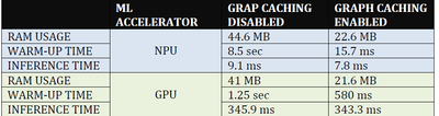

do you mean NPU performance is worse than CPU? it seems that vsi npu calls imx8mp gpu, I have a table about gpu and npu:
