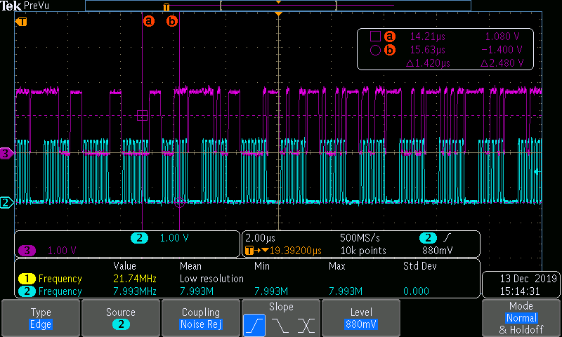

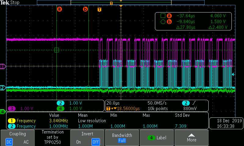

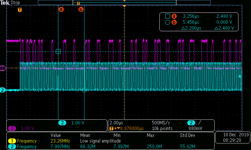

Test command: ./mxc_spi_test1.out -D 0 -s 1000 -b 8 -C a5a5a5a5aa5a5a5a5aa5a5a5a5aa5a5a5a5aa5a5a5a5aa5a5a5a5aa5a5a5a5aa5a5a5a5a
If send small size (less than 31 bytes), SCK is generated continuously. On the contrary, if send big size (more than 32 bytes), SCK is separated. We want SCK generated continuously even for big size. Attach SPI driver to you fro reference. Do you have any suggestion?

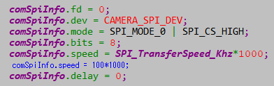

Our application is calling following function to send data by SPI.
ret = ioctl(comSpiInfo.fd, SPI_IOC_MESSAGE(1), spi_message);
About following waveform, the blue channel is SCK, the red channel is MOSI.
  1. When transfer data less than 31 bytes, the SCK signal is generated continuously.
  1. When transfer data is bigger than 32 bytes, the SCK signal is separated into one byte by one byte.
Our usage is Typical Master Mode.

Hi m.c.
one can try to configure BURST_LENGTH described in
sect.10.1.5.3 Control Register (ECSPIx_CONREG)
i.MX 8M Mini Applications Processor Reference Manual
in ecspi driver function spi_imx_probe(), "bits_per_word"
spi-imx.c\spi\drivers - linux-imx - i.MX Linux kernel
igor
