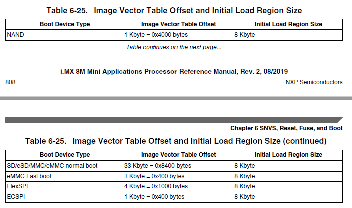

gabrielvalcazar
Hi again James,
A colleague of mind found out what was happening. Our code uses an offset of 0 instead of 32k when writing the imx-boot image to a boot partition on the eMMC, because the Nano's ROM loader reads the SPL from offset 0 when booting from said partition. This isn't true for the Mini though, as its ROM always looks for the SPL at the 33k offset, regardless of the partition being used. After reflecting this behavior in our code, everything works as expected.
We can consider this question resolved now. Many thanks for your input,
Gabriel

4,053 次查看
jamesbone
In the i.MX8M Mini it is a fixed offset where the ROM will look for the header of the image - but note that the offset is differs according to the boot media.

4,033 次查看
gabrielvalcazar
Hi James,
Thanks for the quick reply. We're already aware of the 33 Kbyte offset when booting from eMMC, and we handle it appropriately in our code. What we're concerned about is the eMMC partition from which the SPL is loaded from.
eMMC memories have special boot partitions used to store bootloaders/startup software. In our i.MX8M Nano board, we read the eMMC configuration and deduce the partition used for booting: some eMMCs use the boot partitions, while others use the user data area. The thing is, when we detect in the SPL/U-Boot that the eMMC is configured to boot from the boot partitions (and thus, we write the imx-boot image to that partition), the ROM loader is also able to load the SPL from that partition.
The problem is that our i.MX8M Mini boards behave differently, and the ROM loader is always trying to load the SPL from the user data area, even if the eMMC is configured to boot from the boot partitions. Even if this has an easy workaround (always use the user data partition regardless of the eMMC config), we would like to know if this is expected behavior or if we're missing something.
