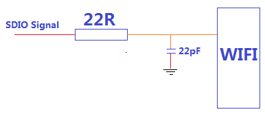

--Can you confirm that 50MHz multiplied peaks occur on the SDIO signal line?
2. On EMI of SDIO signals
For SDIO signals, simple filter below can improve EMI performance:
Just for your reference.
Hope the information is helpful for you.
Have a nice day!

We tried to add 22pF between CLK and GND. Also we have the series resistor in the design. Actually the best result we found was a 39.2ohm series resistor and 26.7pF capacitor close to the wireless module connector.
Also we tried different ferrite beads on the CLK line in the position of the 39.2ohm resistor. Unfortulately none of them increased the performance enough.

OK, good job!
This shows that the filter circuit composed of 39.2ohm resistor and 26.7pF capacitor is suitable for your design.
