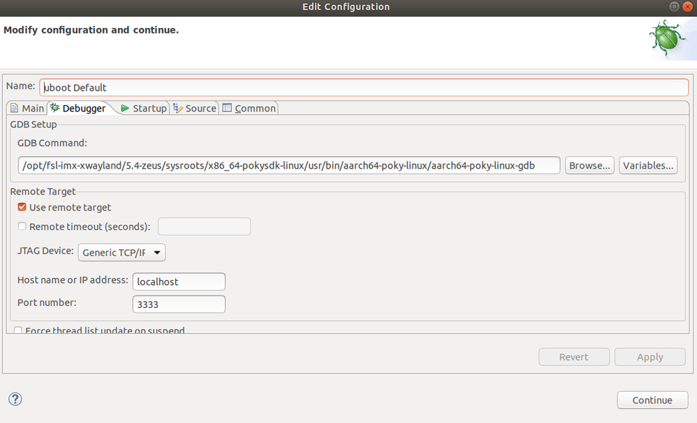

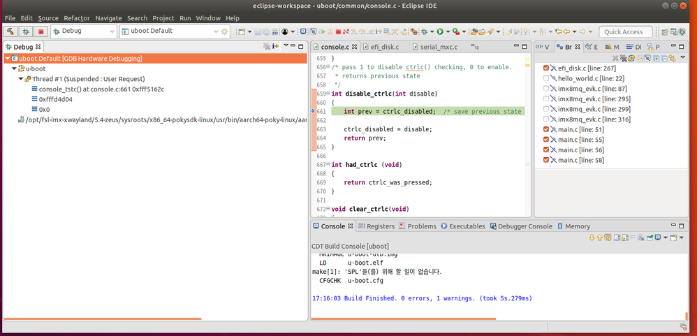

Using  Olimex Jtag Probe,  i am debugging u-boot binary of i.MX8M EVK .
with eclipse-CDT  debugging , there is  breakpoint errors like below.
breakpoint lines  are not the ones that source code indicates and there is some mismatches like  a breakpoint offset error.
openocd binary is from  https://github.com/ntfreak/openocd
run as
###  ./openocd -f interface/ftdi/olimex-arm-usb-ocd-h.cfg -f board/nxp_mcimx8m-evk.cfg

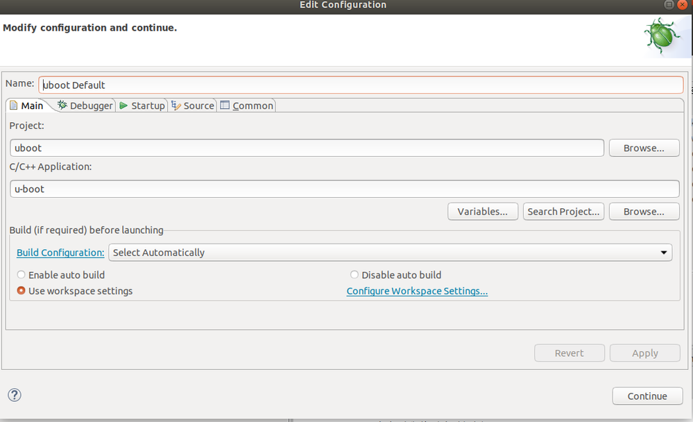

=== Here is Eclipse Debug ====
eclipse debug window
 uboot breakpointsuboot breakpoints

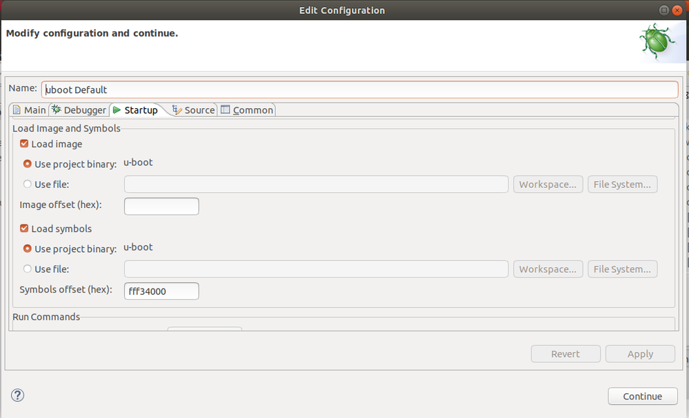

  u-boot Debug Configuration
debug config_1debug config_1debug config_2debug config_2debug config_3debug config_3
-- symbol offset is same as  uboot relocaddr
