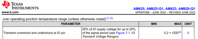

I am working with an i.MX8 and I want to know the transient overshoot and undershoot at IO pin.
In the datasheet only static values are defined, which are -0.3V and VDD + 0,3V
For example Texas defines theses overshoot and undershoot like this.
Thanks and regards

I checked the data sheet, nxp doesn't offer the overshoot and undershoot as percentage like TI, refer to the data sheet,  the minimum allowed undershoot is -0.3V and the maximum allowed overshoot is VDD+0.3V, this is 3.3v+0.3V=3.6v for 3.3v level signal
