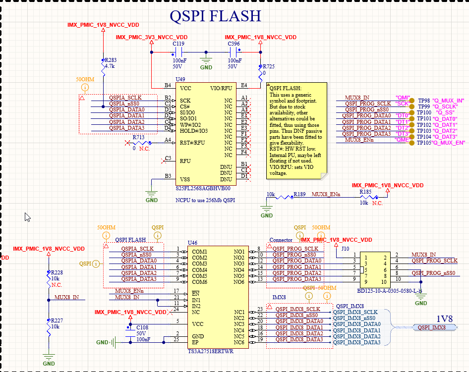

I have some confuse about your schematic, you connect on flash, why your schematic have two flash chips?  My understand is you only connect S25FL256SAGBHVB00 , right?
And what is your command to flash your .bin file to your flash?
B.R
3,969 Views
efio
It's only one flash, the symbol package is divided to two for convenience.

Could you please share your board schematic file and your nor flash datasheet file?
B.R
4,031 Views
efio

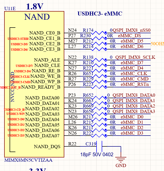

Yes of course, you can see below the schematics for both QSPI Flash and imx8mn.
Please note that I can see the signals over scope and I can communicate with the flash in uboot & linux (read, write and more). The issue occurs only when trying to boot from the QSPI flash.
The mux in the schematics meant for external flash burning - which also works.
As I wrote before about observations of the QSPI controller:
  1. Using an oscilloscope, I monitored the SPI wave and noticed the QSPI controller reading address 0x400 with command 0x3.
  2. The read register value is 0xd1002041, which I believe should be correct.
  3. The controller attempts this read twice.
  4. A third read attempt is made using command 0x13 (4-byte address read), resulting in the same value: 0xd1002041.
  5. After these three cycles, the operation halts.
Any suggestions?
Thank you,
QSPI Flash sideQSPI Flash sideimx8mn sideimx8mn side

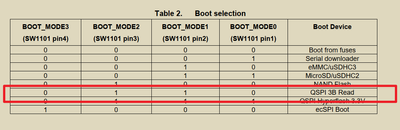

pengyong_zhang
HI @efio
Did you choose the right boot selection? Please refer the following Boot selection for i.mx8MN.
B.R
4,178 Views
efio
Yes I did,
