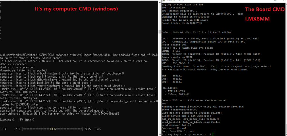

.\uuu_imx_android_flash.bat -f imx8mm -a -e -t emmc -u trusty -d mipi-panel
u-boot-imx8mm-evk-uuu.imx flashed the board.
so show you the board CMD screenshot:
but, something problem found.
Why Not detect the eMMC?

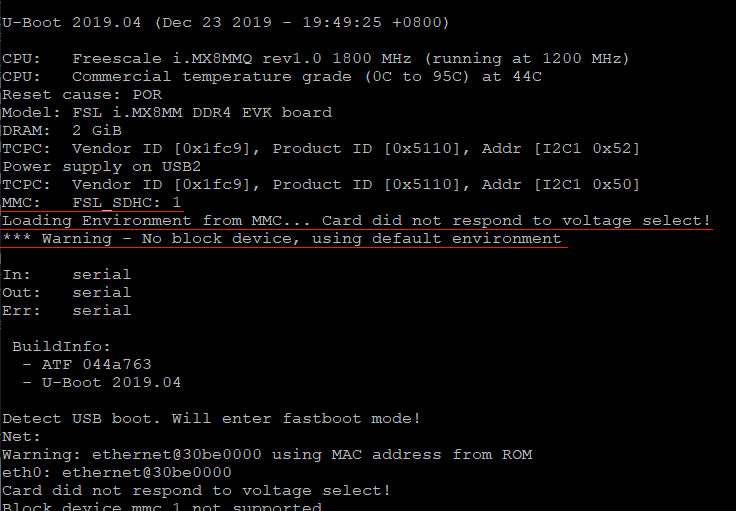

Why U-Boot print out:
Loading Environment from MMC... Card did not respond to voltage select!
*** Warning - No block device, using default environment
and the command  "mmc list" of U-boot:
and "mmc info" of U-boot:

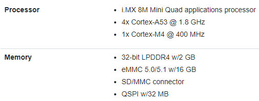

The website states that there is eMMC:
How can I do..?

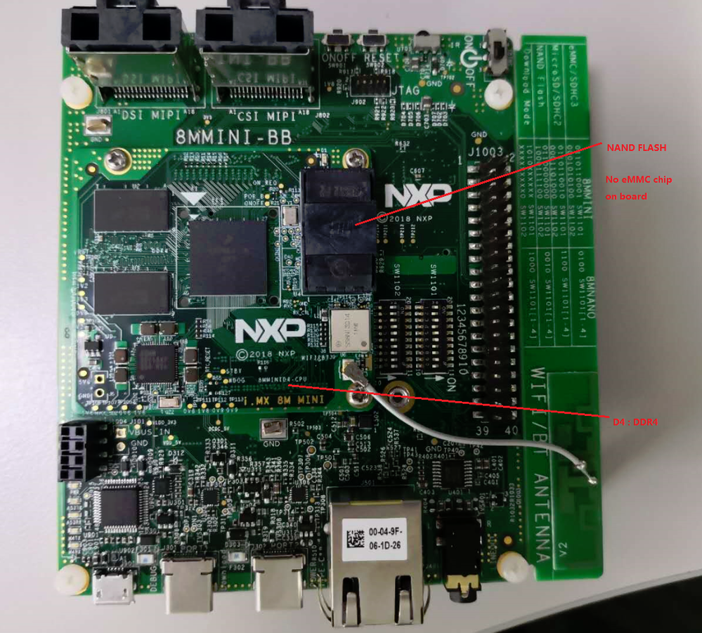

So we have 2 versions of i.MX8MM-EVK: DDR4 + NAND FLASH  & LPDDR4 + eMMC.
If there is a soket for  NAND Flash on your SOM board of I.MX8MM, it is the version of DDR4+NAND FLASH, which doesn't support eMMC on board.
Hope the information is helpful to you.

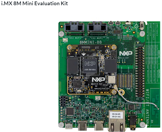

From the picture you pasted, your I.MX8MM-EVK is the verison of LPDDR4, which supports eMMC.
you can check it according to the below:
https://community.nxp.com/thread/532652
Hope above information is helpful to you.

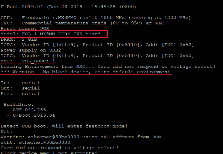

and you answer me what checking the DDR version.
I think DDR is DDR4 because I attach the screenshot:
here, the model is DDR4.
