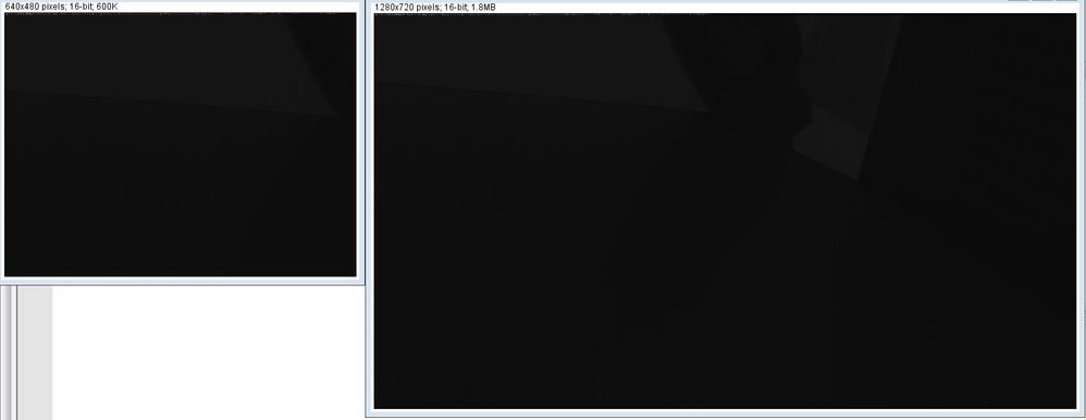

When I use i.MX8 ISI scaling camera frame,1280X720->640X480,ISI driver run this function:mxc_isi_channel_set_scaling()
get picture like this:
It seems crop the image not scale,does ISI have scale ablity?

I make unit test program support RAW data in this case,ISI support downscaling RAW data ot not?

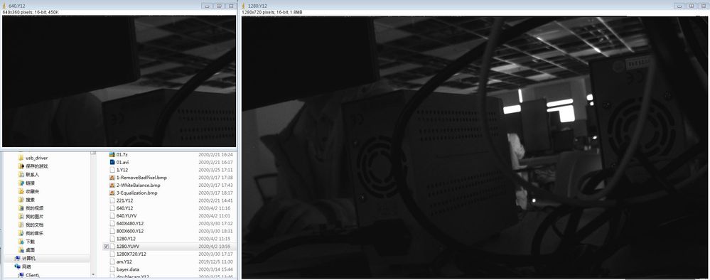

Yes, I use that unit_test application do this test,for detail capture again
With Raw 12bit output camera it is not scale,but YUV camera can scaling:
Why about it?
