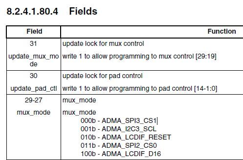

   I am using i.MX8QXP custom board with 4.9.88_beta 2 SDK to develop.
We connect 2 spi slave devices to the LPSPI3 port, but I found the SPI3_CS1 can not config to GPIO.
   In the spi-fsl-lpspi.c , the chipselect should be gpio to let the driver control which spi device to be select.
So my questions are
1.  In LPSPI3 ,  the driver how to control SPI3_CS1 if this pin can not config to GPIO
2. IF SPI3_CS0 , SPI3_CS1 can be set to gpio , what is the correct representation in dts ?
     like below ??
     cs-gpios = <&gpio1 16 GPIO_ACTIVE_LOW> ,  <&gpio1 17 GPIO_ACTIVE_LOW> ,

my spi3 dts part
pinctrl_lpspi3: lpspi3grp {
fsl,pins = <
SC_P_SPI3_SCK_ADMA_SPI3_SCK 0x0600004c
SC_P_SPI3_SDO_ADMA_SPI3_SDO 0x0600004c
SC_P_SPI3_SDI_ADMA_SPI3_SDI 0x0600004c
SC_P_SPI3_CS1_ADMA_SPI3_CS1 0x0600004c
pinctrl_lpspi3_cs0: lpspi3_cs0 {
fsl,pins = <
SC_P_SPI3_CS0_LSIO_GPIO0_IO16 0x21
&lpspi3 {
#address-cells = <1>;
#size-cells = <0>;
fsl,spi-num-chipselects = <2>;
pinctrl-names = "default";
pinctrl-0 = <&pinctrl_lpspi3 &pinctrl_lpspi3_cs0>;
cs-gpios = <&gpio1 16 GPIO_ACTIVE_LOW>;
status = "okay";

andy_cc_huang
Hi Jimmy,
   Thanks for your reply.
But as I said, in the i.MX8 platform,  I can not config the SPI3 CS1 to GPIO.
There is no GPIO option for SPI3  CS1 .
Do you have any comment ?
