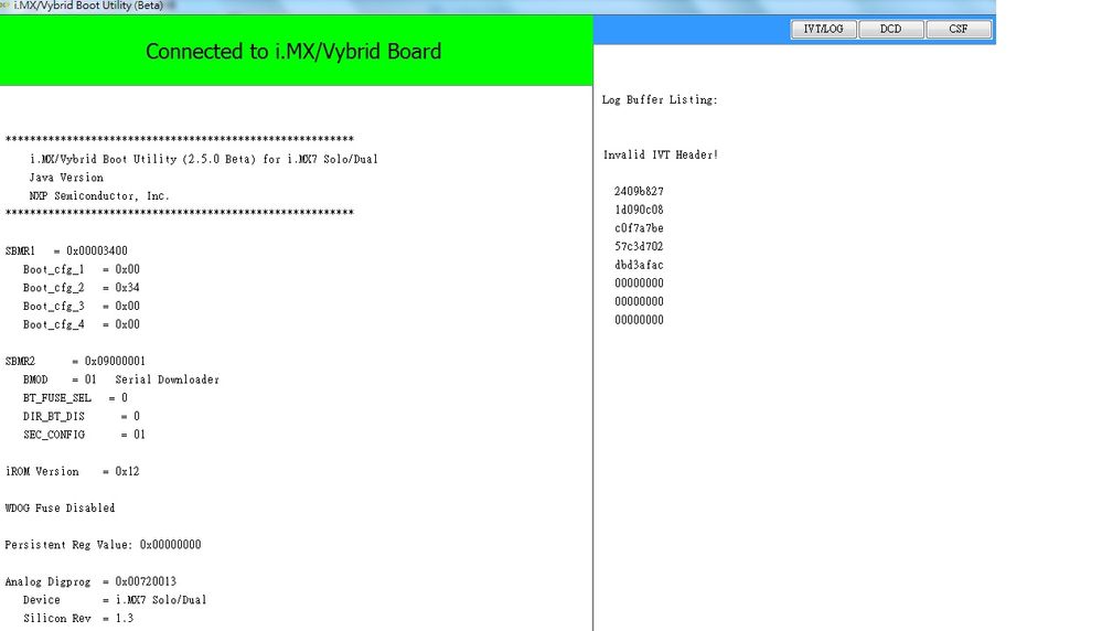

jordan_chen
Hi Yuri,
     Thanks a lot for your help. It would show Invalid IVT Header as below.
I also dump IVT Table via "od" command, it seems like IVT Header "0x402000d1" is the same with unsigned boot image and "E.1. Dumping U-boot binary" of AN4581.pdf.
BTW, I am not sure whether it would be impacted or not for the content of cst-3.1.0/keys/serial would be changed after executing hab4_pki_tree.sh script.
(e.g. echo 12345678 > serial, ./hab4_pki_tree.sh and generate keys, cat serial file, it would be changed to 12345684. My environment is Ubuntu 14.04, openssl 1.1.0j.)
[Dump IVT Table]
od -X -N 0x20 u-boot-imx7dsabresd.imx-nand
0000000 402000d1 87800000 00000000 00000000
0000020 877ff420 877ff400 8789e000 00000000
[Log Buffer Listing:]
Invalid IVT Header!
2409b827
1d090c08
c0f7a7be
57c3d702
dbd3afac
00000000
00000000
00000000
Jordan

Yuri
  Image Vector Table Offset in i.MX7 is 0x400.
Can You verify data on boot media?
Yuri.

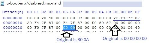

jordan_chen
Hi Yuri,
     OK, I will get help from our EE to rework socket, then dump content of 0x400 from flash later.
BTW, I use Hexedit to change DCD and length which marked with BLUE color to be the same as unsigned boot image.
Then download this modified signed boot image via mfgtool, it can boot successfully.
I check hab_status at boot mode, it has error event.
I am not sure whether this is helpful to clarify original issue or not.
Jordan
