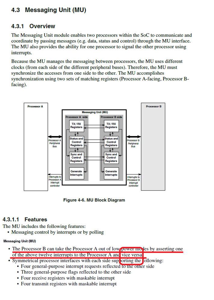

Hi all
Let me confirm about power mode.
I'm checking a section 5.1.4.4 of following document.
http://www.nxp.com/files/32bit/doc/ref_manual/IMX7DRM.pdf
Fisrt, I start both of A7 and M4 core. ⇒ Both core are in "RUN" state.
Then, I chage a mode of A7 to "SUSPEND". ⇒ A7 is in "SUSPEND" and M4 is in "RUN" state.
Finaly, M4 turn out A7 by interrupt signal. ⇒ Both core are in "RUN" state.
Can i.MX7D do that?

Here is answer from the reference manual, which download from the link you provided.

art
Yes, i.MX7D can do that.
There are the BSPs for the i.MX7D SABRE SD board, the Linux L4.1.15_2.0.0_iMX7D that runs on the A7 core(s) and FreeRTOS_iMX7D_1.0.1 that runs on the M4 core. Both are available here (check the "Board Support Packages" section):
http://www.nxp.com/products/software-and-tools/hardware-development-tools/sabre-development-system/s...
Being loaded together to the board, they allow to test the feature you describe. The documentation is included into the packages.
