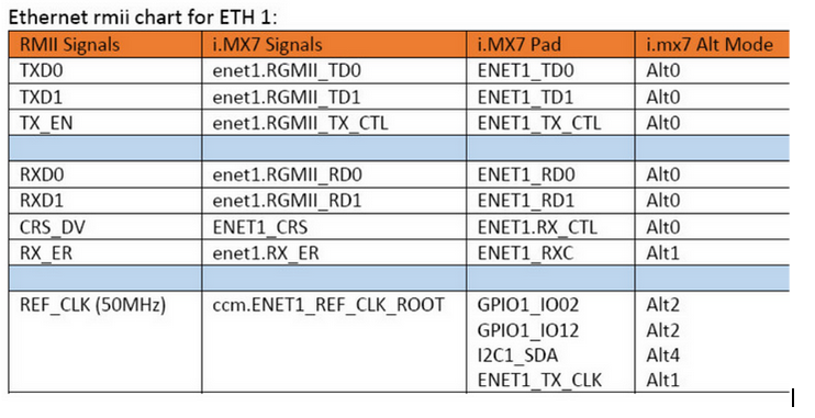

 Pin connections are as this;

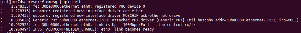

Dmesg output is;
[ 1.243155] fec 30be0000.ethernet: Invalid MAC address: 00:00:00:00:00:00
[ 1.249973] fec 30be0000.ethernet: Using random MAC address: 56:47:52:60:e4:f0
[ 1.258273] libphy: fec_enet_mii_bus: probed
[ 1.264233] fec 30be0000.ethernet eth0: registered PHC device 0
[ 8.445135] Generic PHY 30be0000.ethernet-1:00: attached PHY driver [Generic PHY] (mii_bus:phy_addr=30be0000.ethernet-1:00, irq=POLL)

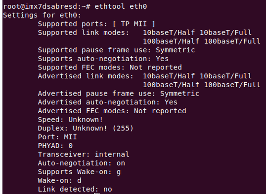

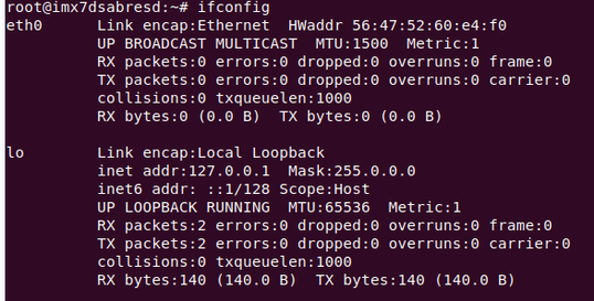

 ifconfig and ethtool outputs
Since the speed and duplex settings are currently unknown, it suggests there might be a problem with the driver.
I can see MDIO and MDCLK at 2.5 MHz, and ETH_REF Clock at 50 MHz with an oscilloscope. However, there's no activity on TXD[0,1], RXD[0,1], TX_EN, RX_CTL, or RXC pins. All of these pins are low.
Do you have any suggestions on how to troubleshoot this issue?

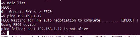

Is this issue persistent in u-boot? Can you ping in u-boot?
3,639 Views
Ahmet_Cihan_AKINCA
Thank you for your reply Josephlinares.
My u-boot version is;
I set ip address 192.168.1.177
when I ping, I get this;

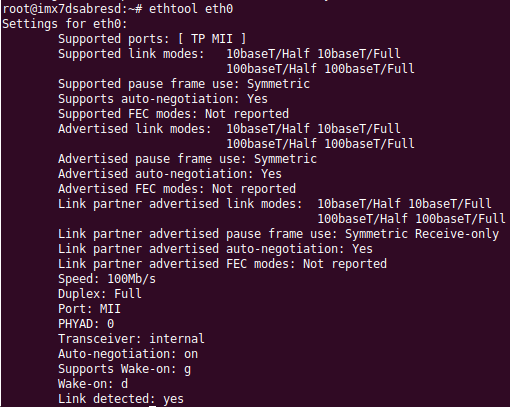

After writing
mdio write 0x1F 0x4000
which is software reset. I get this message in kernel space;
Screenshot from 2024-04-13 17-17-54.pngand "ethtool eth0" shows me
Speed: 100 MB/s
Duplex: Full
If I don't write "mdio write 0x1F 0x4000" on u-boot I see
Speed: Unknown!
Duplex: Unknown!
link detected : no
here. In u-boot, I have changed #define CONFIG_FEC_XCV_TYPE         RGMII
to RMII in ./include/configs/mx7dsabresd.h .
Also, in  ./board/freescale/mx7dsabresd/mx7dsabresd.c  I have changed
ret = set_clk_enet(ENET_125MHz)
to ENET_50MHZ
Still I cannot get ping ..
