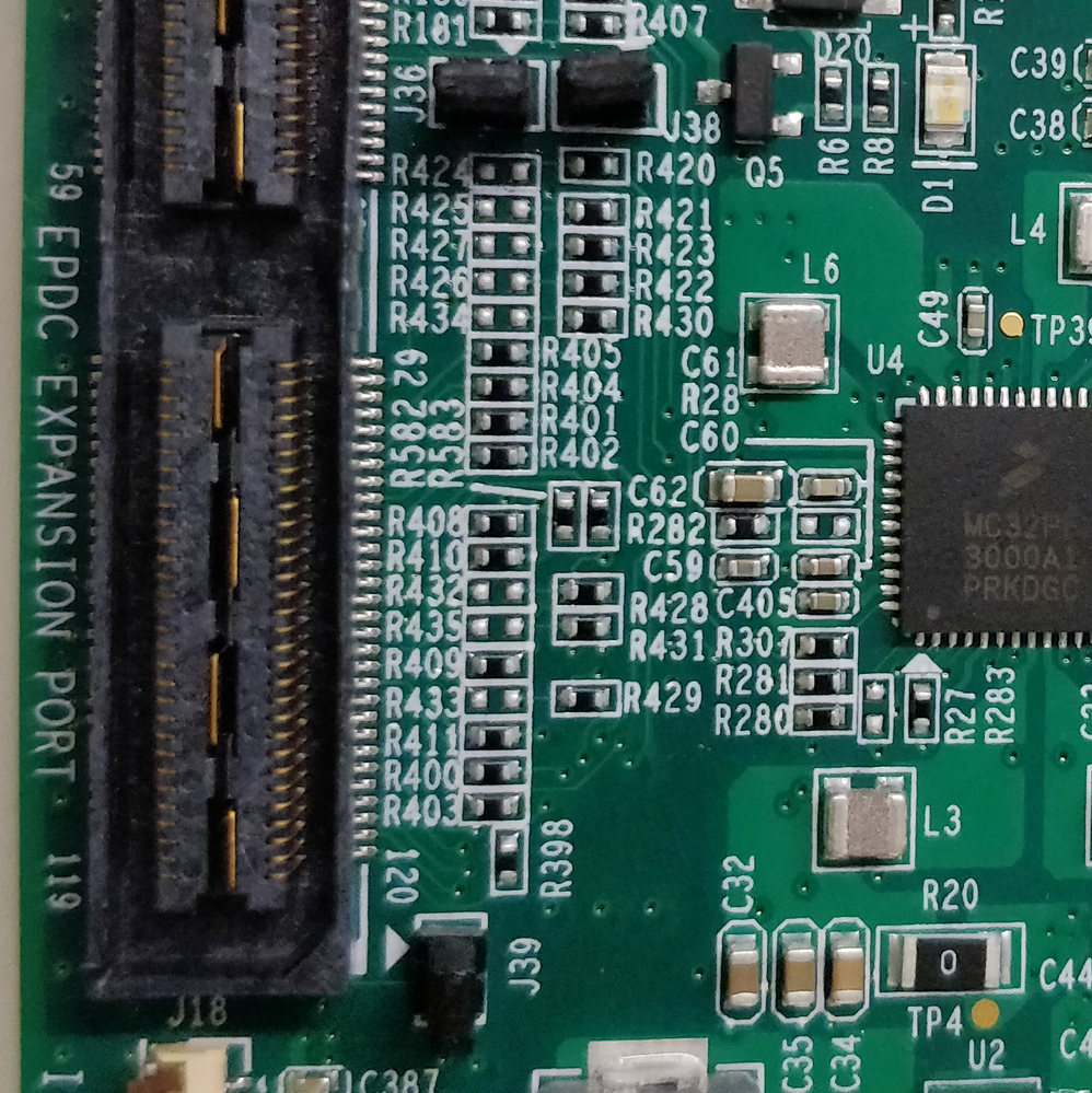

Hello igorpadykov‌,
The past thread that was closed is for Rev-A IMX7D board, But now I have Rev-D IMX7D Sabre board that is behaving much like on other board despite of having J36-J39 jumpers connected and in-place. I have been trying with demo images for imx7D without any success.
Error noticed:
elan-touch 2-0010: elan - Read Hello Packet Failed
elan-touch: probe of 2-0010 failed with error -5
Jumpers J36-J39:
Is there any other DIP switch setting that I need to change? I am booting in default mode with SD and SW2 & SW3 are set to "0". As usual the E-INK panel works without any issues but ELAN touch is not probed as expected.
DTB used: imx7d-sdb-epdc.dtb
Kernel driver enabled:
root@imx6ul7d:~# zcat /proc/config.gz | grep -i ELAN_TS
CONFIG_TOUCHSCREEN_ELAN_TS=y
Another thing noticed, Even though I have Rev-D board, the u-boot reports the board as Rev-A, Is this known behavior?

igorpadykov
Hi Srikant
please try to debug it, revision is defined in function mx7sabre_rev(void) :
uboot/board/freescale/mx7dsabresd/mx7dsabresd.c
uboot-imx.git - Freescale i.MX u-boot Tree
and probe function in ..input /touchscreen/elan_ts.c, check with oscilloscope
signals on J36-J39.
