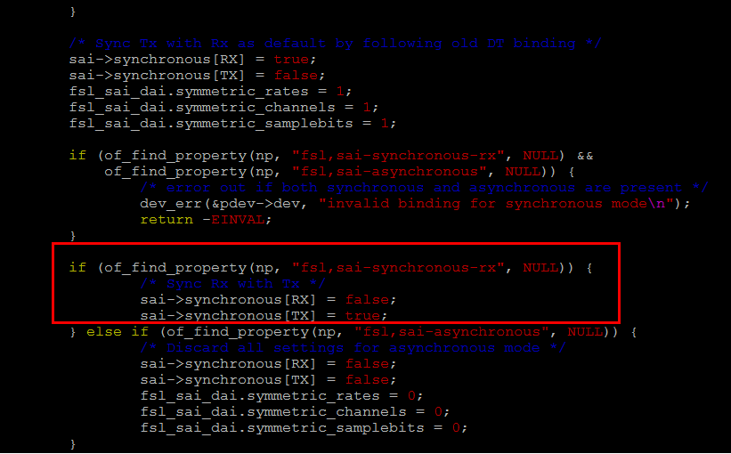

    About this question, there exist 2 kinds of different advice : Yes or No. I just communicated with Software AE (Max) in TaiPei, He gave a patch for you current connection, the code should be sent to you, I can also paste them here, please try it!
diff --git a/sound/soc/fsl/fsl_sai.c b/sound/soc/fsl/fsl_sai.c
index 79c23fd..42568d9 100644
--- a/sound/soc/fsl/fsl_sai.c
+++ b/sound/soc/fsl/fsl_sai.c
@@ -860,8 +860,8 @@ static int fsl_sai_probe(struct platform_device *pdev)
        /* Sync Tx with Rx as default by following old DT binding */
-       sai->synchronous[RX] = true;
-       sai->synchronous[TX] = false;
+       sai->synchronous[RX] = false;
+       sai->synchronous[TX] = true;
        fsl_sai_dai.symmetric_rates = 1;
        fsl_sai_dai.symmetric_channels = 1;
        fsl_sai_dai.symmetric_samplebits = 1;
TIC   Weidong Sun

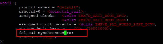

We had tried this solution via adding DTS "fsl,sai-synchronous-rx".
And with this config, the SAI driver will set RX=false, TX=ture.
If dump the register, we can get the RX has been set as sync mode, and TX as async mode.
But the SAI function still can not work.

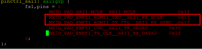

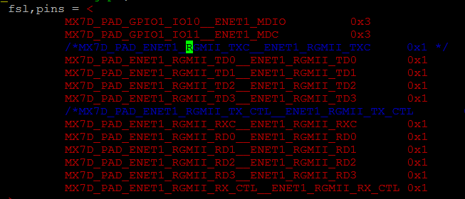

frankyhsu
We have rework the Saber board to the RX_bclk/FS. Before we rework, the aplay can work. We can see the clk and even the TX/RX DATA when aplay or record. Sure, for the new configuration on saber board, we have also modified the FW setting as the DRM document mentioned. Set RXBCLK to async and TXBCLK to sync mode. The result is fail and shows "shows "pcm_write error: Input/output error"".  Would you please help to check if there are further setting needing to modify?
1) DTS file: modify pin mux define for RX_BCLK/RX_FS
2) DTS file: change RX and TX sync mode
