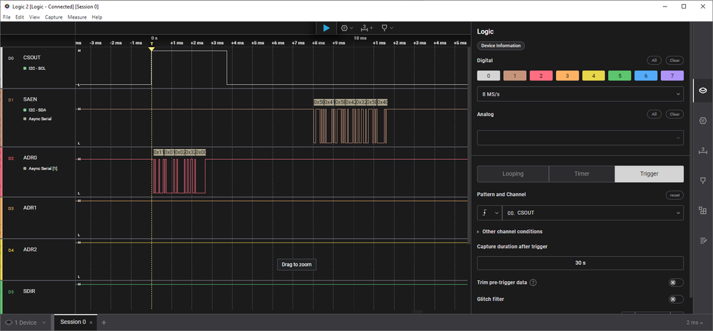

I'm trying to get RS485 running on our custom i.MX7D based board.
I can write some data to RS485 correctly, but when any data is received, there are some random data automatically generated to the line probably by imx.c driver. I have tried to interconnect 2 RS485 lines, open them from C++ code and just write few bytes to one of them and it results in endless pinging of random data on the line.
Both RS485 are working in half-duplex mode with SN65HVD1780 chip, direction control using RTS as GPIO.

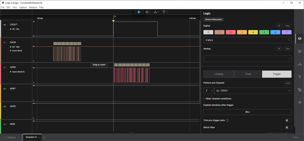

Result caught on analyzer (1 - DIR, 2 - RX, 3 -TX):
As you can see, there is also problem, that on first transition with normal data, RTS delay before send (delay_rts_before_send) is not applied. On randomly generated transitions it is applied correctly.
Any ideas, what am I doing wrong, or I have hit some kind of bug?

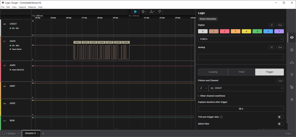

To simplify the usecase, this happens, when I
echo "12345" > /dev/ttymxc3
with interconnected port 2 and 3 (port 2 is with connected analyzer)

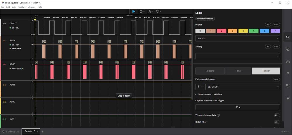

It seems OK. But when I run
cat /dev/ttymxc2
and
which opens the receiving port (but does not process data in any way), it looks like this:
It seems, that data is automatically echoed back to transmit after receive (even with correct RTS).
If I disable DMA, First byte is echoed immediately and rest of data is cut (because of direction change).
