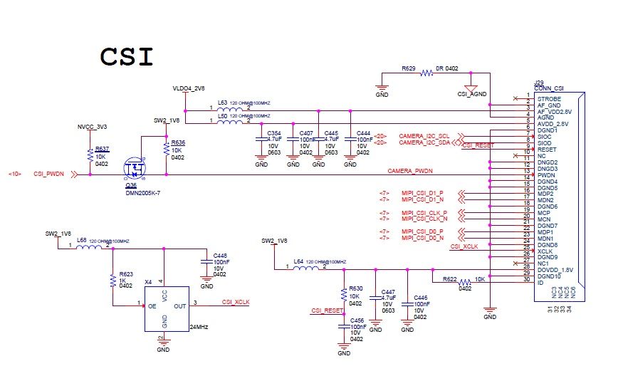

Hi ,
We check iMX7 demo board MIPI connector pin define is not the same as i.MX6Q SabreSD board.
But base on i.MX_Linux_Release_Notes.pdf of fsl-yocto-L4.1.15_2.1.0-ga  version ,OV5640_MIPI already in AVL list.
Can you give me mipi camera module vender list and part number  ?
IMX6SabreSD MIPI schematic
MX7 Demo board MCIMX7Sabre demo board  MIPI Camera sch
fsl-yocto-L4.1.15_2.1.0-ga , i.MX_Linux_Release_Notes.pdf

Hi Apollo
OV5640 Camera Module for i.MX6 boards
OV5647 mipi camera had also been verified on iMX7D board,
ov5647_mipi driver for iMX7: drivers/media/platform/mxc/subdev/ov5647_mipi.c.
