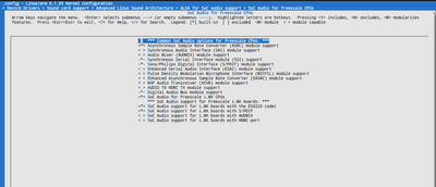

Good afternoon, dear NXP! I kust received my i.MX6ullevk-14x14 board. I compiled the final 6.1.65 LTS kernel from Linus GIT with the options:
make imx_v6_v7_defconfig
make -j32
Everything is OK, but Audio codec is not working and I cannot understand why (7.09 sec):

How I see in i.MX Linux Reference Manual - there is no option in the final 6.1 kernel from kernel.org from the part 7.1.4.6 Menu Configuration Options
-> Device Drivers
-> Sound card support
-> Advanced Linux Sound Architecture
-> ALSA for SoC audio support
-> SoC Audio for Freescale CPUs
-> SoC Audio support for i.MX boards with wm8962 (or wm8958,
wm8960)
Unfortunately there is no such an option. Maybe I should use another kernel version special for i.MX6ull? If this, where can I find this?
