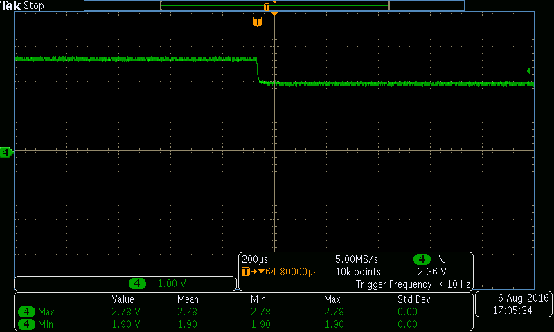

I am  facing an issue, while resetting i.MX6ul via POR button. This issue is occurs when LCD_RESET pin (MX6UL_PAD_LCD_RESET__GPIO3_IO04   )  is connected to  WL_REG_ON pin of Murata 1DX module (BCM4343w).
When I reset i.mx6ul via POR, the LCD_RESET goes to low 1.9V from 2.78V ( 2.78V due to LCD_RESET pin has been configured with 47K internal pull up and WL_REG_ON  pin has internal pull down of 200K)   and i.MX6ul stuck at there. Please find below waveform of  LCD_RESET.

Please help us to resolve this issue as soon as possible
Is there any way to disable 200K pull down on WL_REG_ON  pin of Murata 1DX module ? (As per datasheet, mentioned that it can be disabled by programming)
Is there any new wifi firmware available for Murata 1DX module (4343w) ?

Hi Dhvanil
at reset LCD_RESET is set as input according to Table 95. 14x14 mm Functional Contact Assignments
i.MX6UL Datasheet. http://cache.freescale.com/files/32bit/doc/data_sheet/IMX6ULCEC.pdf
One can reconfigure it as output in uboot.
For  reprogramming Murata module and new firmware one can apply to this module vendor support
http://wireless.murata.com/eng/products/rf-modules-1/wi-fi-bluetooth-for-freescale-i-mx.html
igor

HI igor,
Thanks for reply.
In our case the "LCD_RESET" pin is configured as "High" at kernel level. we are not using it in u-boot level.
When we send signal to POR pin of i.mx6ul, then we observed the above waveform and the i.MX6ul is hang in bootroam mode.It is not able to boot.
Please share the behaviour of the "LCD_RESET" pin during POR sequence

Hi Dhvanil
behaviour of the "LCD_RESET" pin during POR sequence can
not be changed.
