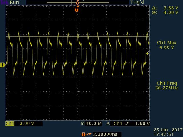

We want to set i.MX6ULL output 800x600-60 VESA timing.
We use 4.1.15_1.1.0 BSP version
My device tree display timing is
display0: display {
        bits-per-pixel = <16>;
        bus-width = <24>;
display-timings {
            native-mode = <&timing0>;
            timing0: timing0 {
                clock-frequency = <40000000>;
                hactive = <800>;
                vactive = <600>;
                hback-porch = <88>;
                hfront-porch = <40>;
                vback-porch = <23>;
                vfront-porch = <1>;
                hsync-len = <128>;
                vsync-len = <4>;
                de-active = <1>;
                hsync-active = <1>;
                vsync-active = <1>;
                pixelclk-active = <0>;
and lcdif_sel is select pll5
I also check clock tree information.
   pll5_bypass_src                       1            1    24000000          0 0
       pll5                               1            1   649515096          0 0
          pll5_bypass                     1            1   649515096          0 0
             pll5_video                   1            1   649515096          0 0
                pll5_post_div             1            1   324757548          0 0
                   pll5_video_div           1            1   324757548          0 0
                      lcdif_pre_sel           1            1   324757548          0 0
                         lcdif_pred           1            1   108252516          0 0
                            lcdif_podf           1            1    36084172          0 0
                               lcdif_pix           1            1    36084172          0 0
                               iomuxc           0            0    36084172          0 0
                               lcdif_sel           0            0    36084172          0 0
And We also check waveform from scope , clock is 36.27M
How to let lcdif_sel out 40MHz ?

Hi Appolo
one can try to set pll5 (which is currently = 649515096) to other frequency
so it could be divided to produce 40MHz. One can printf ccm registers
following Figure 18-2. Clock Tree i.MX6ULL RM
http://www.nxp.com/docs/en/reference-manual/IMX6ULLRM.pdf
Also may be useful try to change clock sources using example on
IMX6Q Device Tree Binding for ADV7343 Encoder
igor

Hi Sir,
As I understand ,i.MX6Q/D/DL/SOLO can reference device tree "clock-frequency" to output currect pixel clock if we use pll5.
Does mxsfb.c don't reference  "clock-frequency" ?
OR
If I need to setting VESA timing *640x480-60 ,800x600-60" , I need to add PLL5=fixed clock into C file ?
