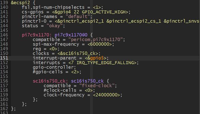

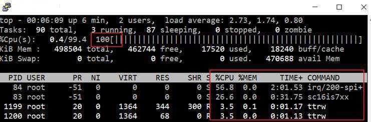

Customer use i.MX6ULL+SPI to UART (Pericom PI7C9X1170) and found CPU usage high.
Any experience use i.MX with SC16IS740/750/760?

this configuration was not used in official nxp bsps, so I am afraid there is no such
experience. In general one can try to use ecspi with dma, add  "dmas" property
fsl-imx-cspi.txt\spi\bindings\devicetree\Documentation - linux-imx - i.MX Linux kernel
or assign this task to M4 core using SDK:
The 'dmas' is enabled in imx6ull.dtsi. It doesn't help the issue.
