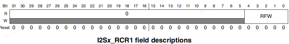

      fsl-sai-i2s-rx 2028000.sai: SAI Receiver Configuration 1: 0x00000010
      接收Watermark 0x10 = 16,默认值之前设置为6 - 1 = 5也试过,一样。

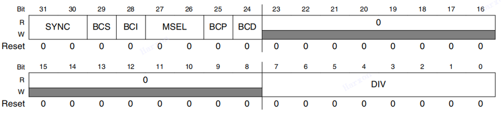

      fsl-sai-i2s-rx 2028000.sai: SAI Receiver Configuration 2: 0x02000000
      BCP Bit Clock Polarity 位时钟极性 = 1
      Bit Clock is active low with drive outputs on falling edge and sample inputs on rising edge.

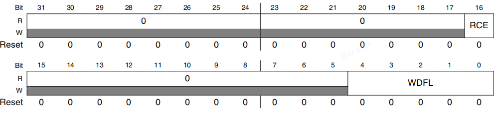

      fsl-sai-i2s-rx 2028000.sai: SAI Receiver Configuration 3: 0x00010000
      RCE = 1, 这个位是在fsl_sai_hw_params()函数中设定的。

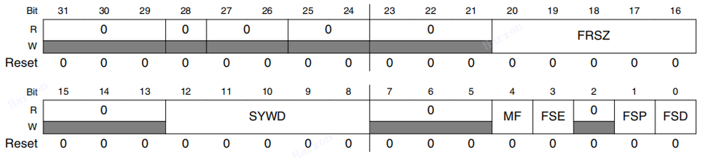

      fsl-sai-i2s-rx 2028000.sai: SAI Receiver Configuration 4: 0x00011f10
      这里:MF = 1, MSB, 其余 FSE,FSP,FSD 都为0
      SYWD:Configures the length of the frame sync in number of bit clocks, 这个数值范围为0 ~ 31,一帧数据有多少个bit clock。在RX的接收程序中,这里为31,0x1f
       FRSZ: Configures the number of words in each frame. 这个输入范围为0 ~ 31,一帧,多少个Word,Word大小为32,下一个寄存器配置的,这里配置俩个Word,2 - 1 = 0x1

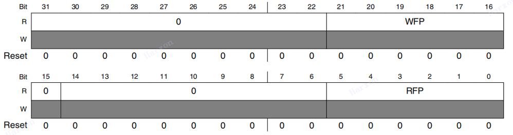

     中断触发时,打印的寄存器的值:
     fsl-sai-i2s-rx 2028000.sai: isr: Receive overflow detected, RFR0:0x00200000, RDR0:0x00695a00
     fsl-sai-i2s-rx 2028000.sai: isr: Receive overflow detected, RFR0:0x00000020, RDR0:0x00694d00

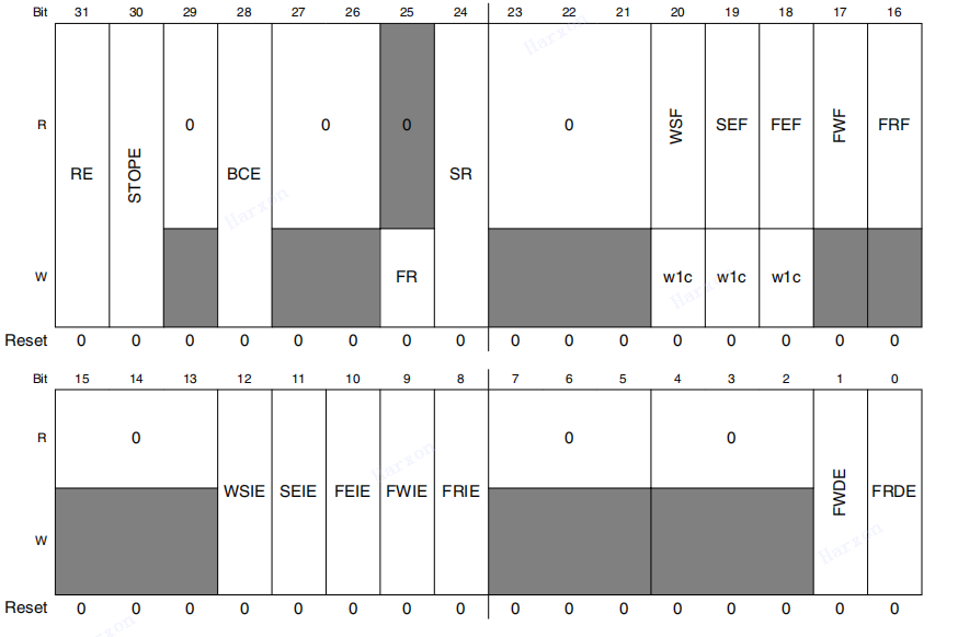

     RCSR寄存器的值:SAI Receiver Control        : 0xd0000c01
     这个寄存器,我们配置了FSL_SAI_CSR_FRDE, FSL_SAI_CSR_SEIE,FSL_SAI_CSR_FEIE,FSL_SAI_CSR_TERE,FSL_SAI_CSR_SE。
