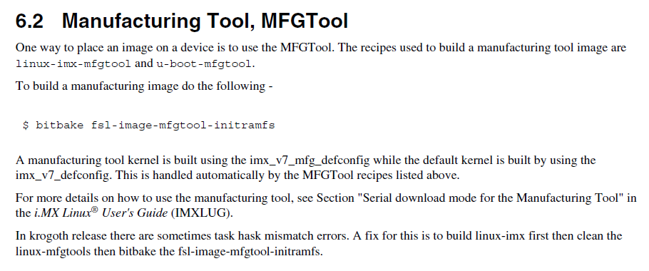

In the MFG tool i am using "fsl-image-mfgtool-initramfs-imx_mfgtools.cpio.gz.u-boot" was missing in path "Mfgtool/profiles/Linux/OS firmware/firmware/" .
When i tried to flash i.mx6ul custom board i got below error in MfgTool.log file
DLL version: 2.7.0
Monday, February 19, 2018 18:12:09   Start new logging
ModuleID[2] LevelID[1]: Load command--file C:\Users\Desktop\Linux4.1.15-MFG_EMMC\Profiles\Linux\OS Firmware\firmware\fsl-image-mfgtool-initramfs-imx_mfgtools.cpio.gz.u-boot failed to open.errcode is 2
ModuleID[2] LevelID[1]: Parse ucl script failed, error code: 4
I copied "fsl-image-mfgtool-initramfs-imx_mfgtools.cpio.gz.u-boot" from other MFG tool .
What is the use fsl-image-mfgtool-initramfs-imx_mfgtools.cpio.gz.u-boot file in MFG tool?
How it is generated ?
Is board specific?
Thanks in advance.

The mfgtool works following the ucl2.xml file. The download prosess you can see the ucl2.xml file.
<CMD state="BootStrap" type="load" file="firmware/%initramfs%" address="0x12C00000"
        loadSection="OTH" setSection="OTH" HasFlashHeader="FALSE" ifdev="MX6Q MX6D">Loading Initramfs.</CMD>
    <CMD state="BootStrap" type="load" file="firmware/%initramfs%" address="0x83800000"
How the generate the fsl-image-mfgtool-initramfs-imx_mfgtools.cpio.gz.u-boot you can see the details in the i.MX_Yocto_Project_User's_Guide
Hope this can do help for you.
