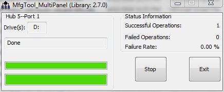

I can program QSPI NOR flash memory on the i.MX6UL-EVK using manufacturing tools L4.1.15_2.0.0-ga_mfg-tools (mfgtool2-yocto-mx-evk-qspi-nor-n25q256a.vbs was executed). After changing the boot mode and reset the board, u-boot ran OK, but it couldn't load zImage. The u-boot console message is shown below:

The programming was successful as shown in the following screen capture:
The console messages while programming is attached in the attachment.
Can you tell me what I've done incorrect?

Hello Charles,
in default settings MFG tool sends only U-Boot to QSPI device. In the ucl.xml file, you can find that the commands used for sending the kernel, device tree and rootfs are missing. This is because QSPI devices usually have too small capacity for the entire image.
