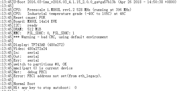

Hi all:

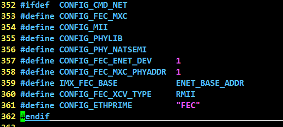

The ethernet PHY of my new board is DP83848J, and I changed mx6ul_14x14_evk.h
rebuild the uboot. When I download the uboot mirror to the board,the following error is displayed.
Anyone have any suggestions on what might be wrong or what next to check to get Ethernet working in uboot?

igorpadykov
Hi kane
for error FEC1 address not set one can check
uboot env parameters, like setenv ethprime, setenv ethact, setenv ethaddr.
Can u-boot support more than one ethernet port? - Stack Overflow
igor
