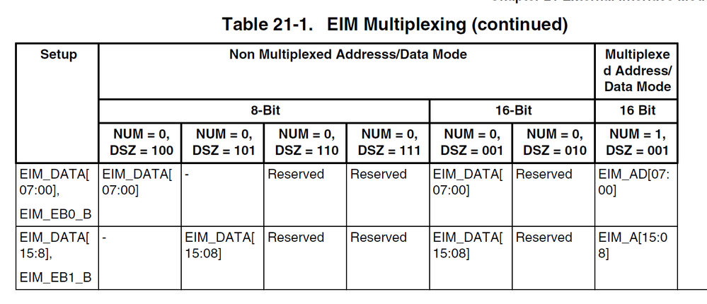

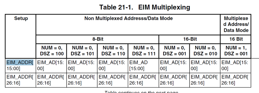

You can realize the EIM connect to the FPGA yourself. You can see the RM
