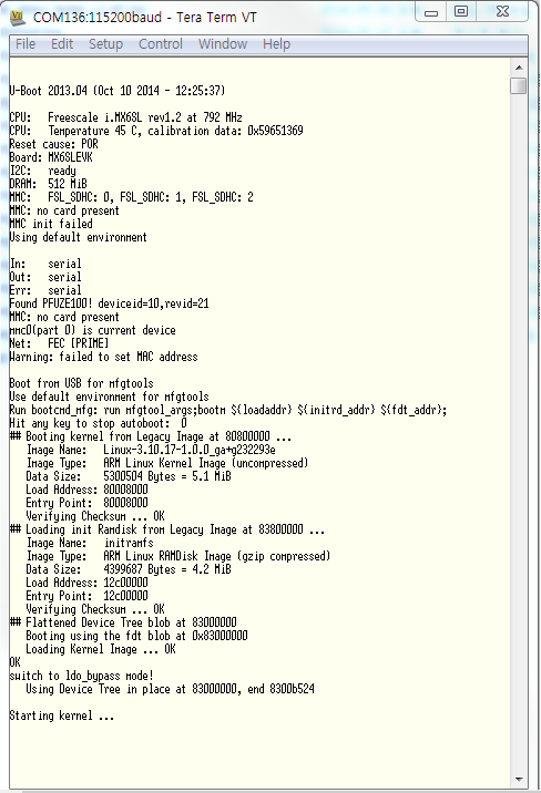

igorpadykov
Hi DaeYongLEE
MCIMX6L2EVN10AB has not gpu,epdc so please rebuild linux image
without these peripherals, check sect.13.1.1.6 Menu Configuration Options
attached Linux Manual. Note, for new processor part ddr test should be run and
new calibration settings provided in uboot ".cfg file.
Regarding mfg tools, it is necessary to rebuild firmware, removing from
image gpu,epdc, as shown in attached Yocto Guide Table 1. Freescale Yocto Project
images, "fsl-image-manufacturing".
igor
7,011件の閲覧回数
daeyonglee
Hi igor.
Thank you for your quick response.
I have build a image.
(the build image is "fsl-image-manufacturing-imx6slevk.ext3")
I have still problem for download firmeware.
When start download firmware, console message show last message "Starting kernel" and then don't processing next operation.
(Please note that below image)
The previous mfgtool using mfgtool2-imx6sl-es2-sdcard-emmc.vbs
I have read manual but i don't still know how to set mfgtool for "fsl-image-manufacturing-imx6slevk.ext3".
Please could you provide the relevant files or description?
Thank you for your support.
DaeYong
7,011件の閲覧回数
igorpadykov
Hi DaeYong
when built "fsl-image-manufacturing"
had you run ddr test and entered new calibration settings in uboot ".cfg file ?
