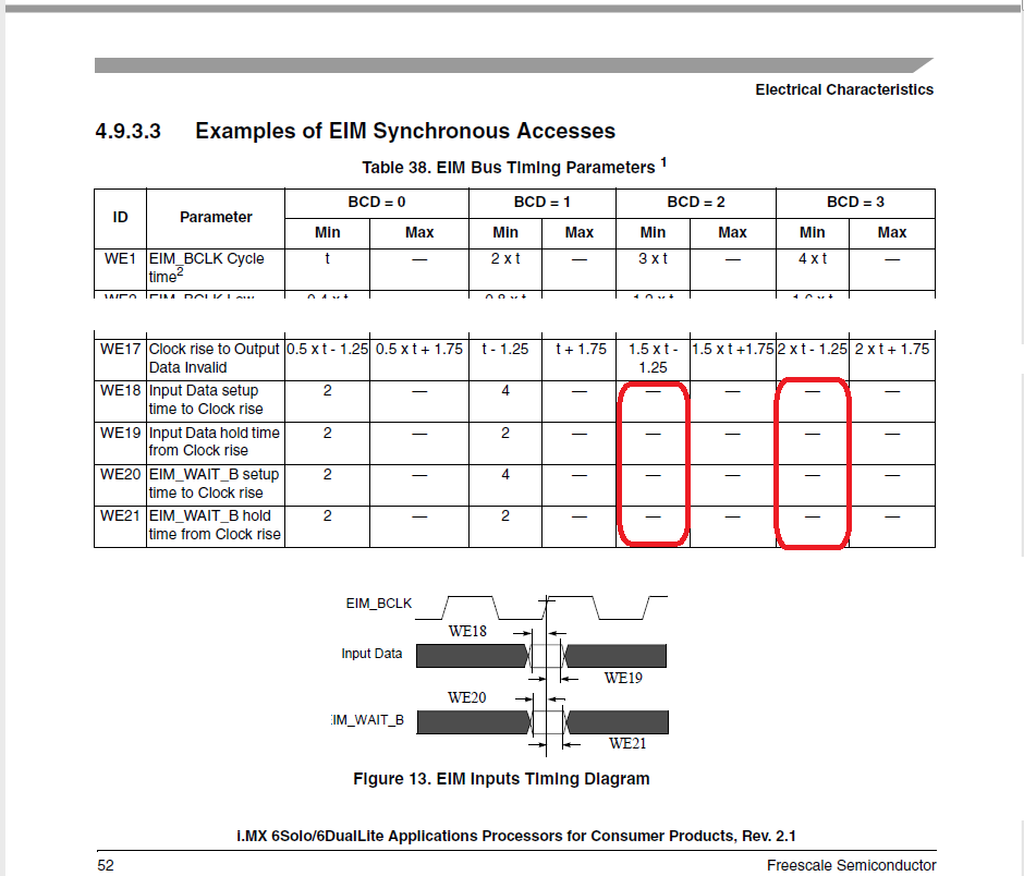

I am just curious about blank of IMX6SDLCEC datasheet as following.
Why setup/hold timing(WE18-21) didn't specify in case of BCD=2 or 3?
(Are those same as BCD=1?)
Can anyone help me?
Thanks.
         Note: BCD=Burst Clock Divisor

Hi torus1000
you are right, those same as BCD=1, just for reference
one can check i.MX6DQ Datasheet where similar table is a bit clear.
