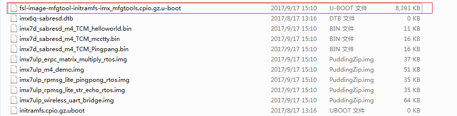

   I want to reduce the booting time. I am using imx6QP with Yocto Morty and kernel version is 4.9.11. To reduce booting time, I created ramdisk with following change in my conf/local.conf:
INITRAMFS_IMAGE = "esomimx6-initramfs"
INITRAMFS_IMAGE_BUNDLE = "1"
I obtain a cpio.gz file but I cannot boot the system. Do I need to change u-boot, environmental variables or something else?

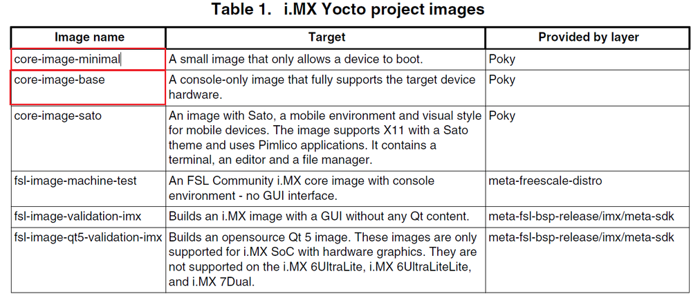

Hi Can,
>>Is it possible to run the file system in RAM?
yes, it is possibe.
>>If yes, does this change reduce booting time?
yes,it does. because it is very small.
Actually, ramdisk is also a kind of rootfs, whose usage is the same as that of common one.
BUT you know there are few funtions in it.
So the bettery way to reduce rootfs size on the basis of core-image-minimum.
Hope above information is helpful for you.
Have a nice day!

weidong_sun
Hi Can,
cpio.gz file is for MFG Tools OS Firmware, see below,please!
L4.9.11_1.0.0-ga_mfg-tools\mfgtools\Profiles\Linux\OS Firmware\firmware
If you want rootfs with smalle size, you can select the ways below:
1. Compile minimal rootfs
or
2. reduce the size of rootfs
Before compiling rootfs in yocto, you can specify those packages you don't want.
In build/conf/local.conf, like below:
PACKAGE_EXCLUDE = "package_name package_name package_name ..."
