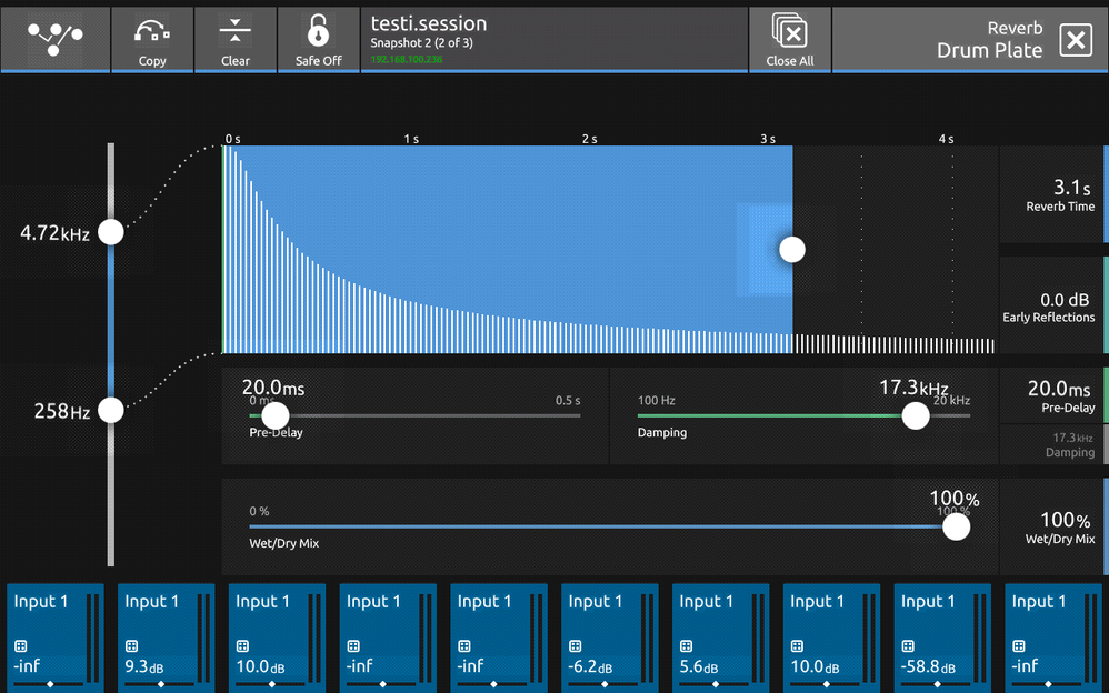

Hi gusarambula
I received an email from our NXP FAE stating this too, but I believe the support team have looked at Gary's screen grabs without noticing his comment about the tearing.
Please see attached screens from our application running on iMX6Q and then iMX6Q Plus. Both are confirmed to be using triple buffering and a vertically synced frame buffer grab. The iMX6Q Plus device clearly exhibits the same issues that Gary's attachments above do despite FB_MULTI_BUFFER=3. Also attached is Qt scene graph debug information showing this.
FB_MULTI_BUFFER=3
QSG: threaded render loop
QSG: texture atlas dimensions: 4096 x 1024
R/G/B/A Buffers:    4 4 4 0
Depth Buffer:       24
Stencil Buffer:     8
Samples:            0
GL_VENDOR:          Vivante Corporation
GL_RENDERER:        Vivante GC2000+
GL_VERSION:         OpenGL ES 3.0 V5.0.11.p7.33433
GL_EXTENSIONS:      GL_EXT_read_format_bgra  GL_OES_packed_depth_stencil GL_OES_fragment_precision_high GL_OES_surfaceless_context GL_OES_texture_npot GL_OES_compressed_ETC1_RGB8_texture GL_OES_depth_texture_cube_map GL_EXT_multisampled_render_to_texture GL_OES_vertex_half_float GL_VIV_direct_texture GL_OES_compressed_paletted_texture GL_OES_rgb8_rgba8 GL_EXT_texture_format_BGRA8888 GL_KHR_texture_compression_astc_ldr GL_EXT_texture_type_2_10_10_10_REV GL_EXT_multi_draw_arrays GL_OES_depth_texture GL_OES_get_program_binary GL_OES_fbo_render_mipmap GL_EXT_frag_depth GL_OES_EGL_sync GL_OES_required_internalformat GL_OES_element_index_uint GL_OES_vertex_array_object GL_OES_depth32 GL_OES_vertex_type_10_10_10_2 GL_EXT_texture_filter_anisotropic GL_OES_mapbuffer GL_EXT_discard_framebuffer GL_EXT_blend_minmax GL_OES_depth24 GL_OES_standard_derivatives GL_OES_EGL_image GL_EXT_robustness
