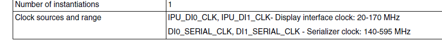

joanxie
refer to the table as below,
one can get displa interface clock from 20-170MHZ, which depends what you need, if you need to set specific lvds, one need to add your own  in /drivers/video/mxc/ldb.c
