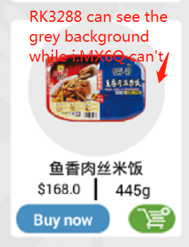

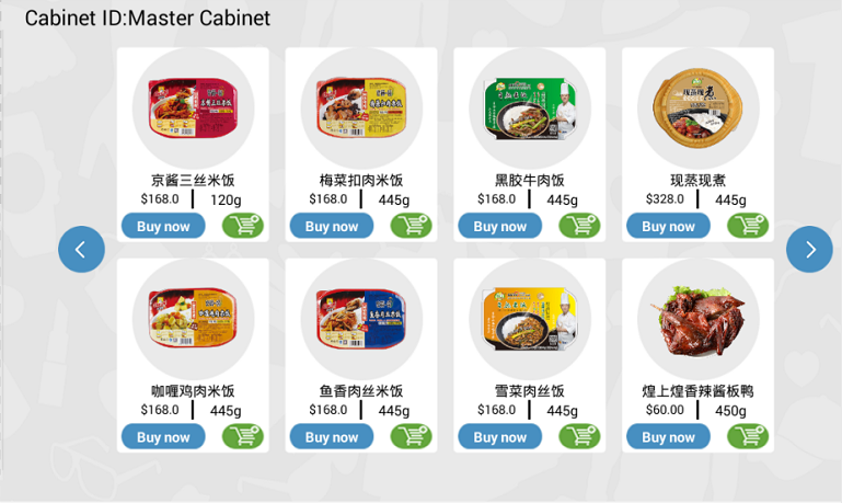

We compare i.MX6Q with RK3288 for picture display via HDMI interface, but find it is different.
1>Condition
a. i.MX6Q running in android 4.4.2, RK3288 running in android 5.1;
b. Display in the same LCD screen via HDMI interface.
2>Test
a.picture display in LCD screen via HDMI interface
b.we scrap the picture data from i.MX6Q DDR, but the picture is OK.
3>Problem
What is the reason , and how can we solve the problem?
Thanks.

Hi igor,
I have try android 5.1, but it is the same.
As I mentioned in 2> b. content,the picture data in DDR is right, so maybe the HDMI interface affects the output data, but I can't confirm.
Note: When I turn down the brightness of LCD screen, then I can see the light grey background.
As to the test, I suspect the picture data is modified via HDMI interface.
Hope you can check again, and find how to improve it.
Thanks.
