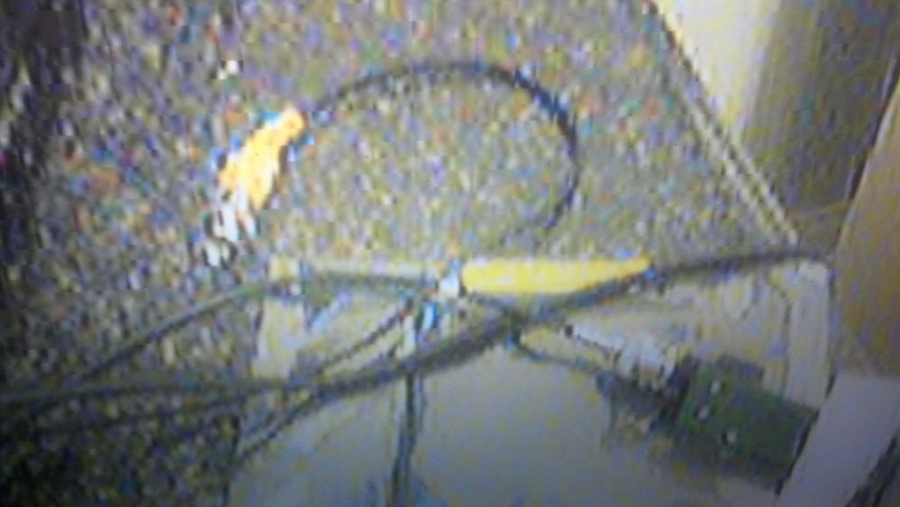

I am decoding video from an IP camera. H.264 video looks good, but, for some reason when I pull the MJPEG stream the quality is very bad. When I view the MJPEG stream on the computer in VLC and such, the video looks great. I have tried with jpegdec and vpudec. Both provide the same poor quality on the screen.

I found the issue was in the rtpjpegdepay element. Update is here if anyone else needs it:

timothybean
Sorry for the late reply
gst-launch rtspsrc=rtsp://IP/mjpg latency=300 ! rtpjpegdepay ! vpudec low-latency=true ! mfw_v4lsink sync=true device/dev/video17
I have also tried:
gst-launch rtspsrc=rtsp://IP/mjpg latency=300 ! rtpjpegdepay ! jpegdec ! mfw_v4lsink sync=true device/dev/video17\
and get the exact same results.
Below is an image of my screen. You can see there IS video but it is very badly pixelated.

timothybean
playbin2 pipeline is same results
video is 720x480
Yes, H.264 works, but only if I set the disp-height to 8 minus the resolution
