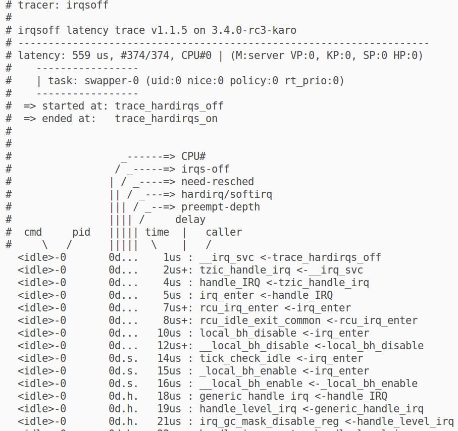

TomE
Specialist II
> I did try that testcase.
There are three different ways to code this. Which one (or ones) did you try?
  1. fwrite(fp);
  2. fwrite(fp); fflush(fp);
  3. write(fd);
The last two should be the same, but should be different to the first one.
> write 512 bytes
You may only have 46 us before the overflow. If the SD card is using a slow SPI channel it might take a lot longer than that to write 512 bytes.
It would be worth measuring the interrupt latency. Take a timestamp on every exit from the SPI RX ISR. When it overflows, grab another timestamp, subtract the first one and "printk()" the result. That will show how long it was between interrupts.
Better still, build a kernel with FTRACE enabled.
I had all the details on how to do this typed in, then "Jive" locked up and lost the lot when I tried to paste some text and it blew up.
ftrace - Wikipedia, the free encyclopedia
That tells you to read the following, which is also with your kernel sources:
https://www.kernel.org/doc/Documentation/trace/ftrace.txt
If you're lucky and your kernel already has this in it, try "mount -t debugfs nodev /sys/kernel/debug".
If this isn't enabled, basically "make menuconfig", then turn stuff on in "kernel hacking / enable tracers  select tracers".
Then interesting stuff shows up in "/sys/kernel/debug/tracing/", including stuff to find what's locking out interrupts. This is the PROPER way to trace down these things.
Not that you'll be then able to rewrite enough of everything to fix it, but it is very educational.
You should get something like this (I'm about to try another paste, it will probably go horribly wrong again...)
# tracer: irqsoff
# irqsoff latency trace v1.1.5 on 3.8.0-test+
# latency: 259 us, #4/4, CPU#2 | (M:preempt VP:0, KP:0, SP:0 HP:0 #P:4)
# | task: ps-6143 (uid:0 nice:0 policy:0 rt_prio:0)
# => started at: __lock_task_sighand
# => ended at: _raw_spin_unlock_irqrestore
# _------=> CPU#
# / _-----=> irqs-off
# | / _----=> need-resched
# || / _---=> hardirq/softirq
# ||| / _--=> preempt-depth
# |||| / delay
# cmd pid ||||| time | caller
  ps-6143 2d... 0us!: trace_hardirqs_off <-__lock_task_sighand
  ps-6143 2d..1 259us+: trace_hardirqs_on <-_raw_spin_unlock_irqrestore
  ps-6143 2d..1 263us+: time_hardirqs_on <-_raw_spin_unlock_irqrestore
  ps-6143 2d..1 306us : <stack trace>
=> trace_hardirqs_on_caller
=> _raw_spin_unlock_irqrestore
=> do_task_stat
=> proc_tgid_stat
=> proc_single_show
=> seq_read
=> vfs_read
=> sys_read
=> system_call_fastpath
(Edit) Not horribly wrong, but the multiple spaces didn't survive, and only the first four lines after "||||" survived.. What is it with a "Show Code" filter that removes multiple spaces and destroys the formatting!
Let's see if I can use raw HTML, plus lots of hacking and editing...
# tracer: irqsoff # # irqsoff latency trace v1.1.5 on 3.4.0-rc3-karo # -------------------------------------------------------------------- # latency: 559 us, #374/374, CPU#0 | (M:server VP:0, KP:0, SP:0 HP:0) #    ----------------- #    | task: swapper-0 (uid:0 nice:0 policy:0 rt_prio:0) #    ----------------- #  => started at: trace_hardirqs_off #  => ended at:   trace_hardirqs_on # # #                  _------=> CPU# #                 / _-----=> irqs-off #                | / _----=> need-resched #                || / _---=> hardirq/softirq #                ||| / _--=> preempt-depth #                |||| /     delay #  cmd     pid   ||||| time  |   caller #     \   /      |||||  \    |   / # [idle]-0       0d...    1us : __irq_svc There was meant to lots of other interesting stuff in here, but "Jive" trips over it and kills it.
That looked fine on my screen. Then it got destroyed so it is now all on one line!
Maybe the only way to show code samples in here is to insert a video or a photo of it, or to attach a separate file that people have to click on to open?
So here's a JPEG PICTURE of the text!
Tom

After receiving data from SPI, we put the data to VPU to decode instead of stroring to SD card. RXFIFO overflow.
We also measured the interrupt latency as you mentioned above, The delay is not constant. sometime 3ms, sometime 20ms
11,782 Views
saurabh206
Senior Contributor III
Huang
Are you able to fixed this issue?
Saurabh
11,778 Views
huang_dexiang
Hi Saurabh,
Sorry for late to reply to you. We still  can not fixed the issue about SPI slave.
How about your's ?
11,781 Views
huang_dexiang
Hi Tom,
     The master running at rate of 11MHz, and it sends 8 bits per assertion of chip select. And there is no flow control during the transfer, the slave couldn't feedback to the master, the master will just sending datum without any interaction.
     I have attached my source code of the driver before, i have to switch the DMA buffer in the CALLBACK of the DMA.
     As for the L2 cache you mentioned, I guest the issue is most  probably caused by flush the L2 cache, but I don't know how to confirm that.
