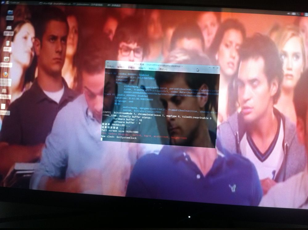

Hello, when playing video using the following command (Gstreamer),  the video image is translucent, why?
gst-launch filesrc location=test.mp4 typefind=true ! aiurdemux ! vpudec ! mfw_v4lsink
How can I make it completely opaque?
Thank you!

Can you try a different sink element? like
ximagesink instead of mfw_v4lsink.
Please let me know how it goes.
