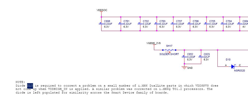

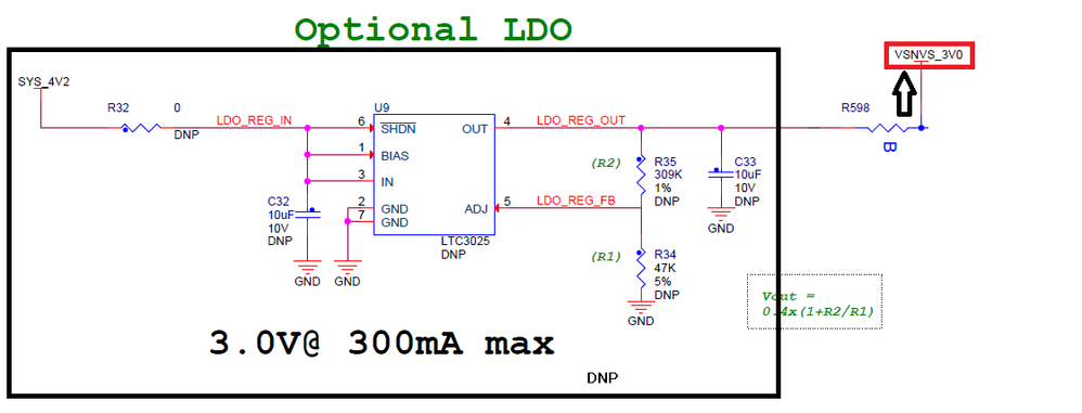

Hello Champs,
In order to cope with higher current requirement for VDDHIGH_IN and VDD_SNVS_IN,
my customer is trying to use the i.MX6Q SabreSD schematics' option.
"Optional LDO" for VDD_SNVS_IN, and FP0100F0 SW4(3.15V) for VDDHIGH_IN.
Now we are wondering what this D10 NSR0320 is for.
#1
In the original design VDDHIGH_IN(VGEN5) is 2.8V and VDD_SNVS_IN is 3.0V.
Now they are trying to use 3.15V for VDDHIGH_IN, which is bigger than VDD_SNVS_IN 3.0V.
What should the D10 be handled in this new design?

igorpadykov
Hi Nori
1. D10 is not needed, its purpose (useful on older processor versions )
described on p.2 sabre schematic spf-27392
2. yes startup order 6 of SW4 is OK for VDDHIGH_IN.
igor

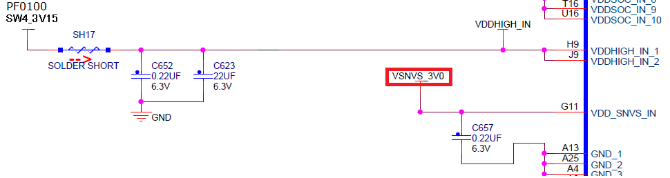

norishinozaki
Contributor V
Hello Igor,
Thank you!

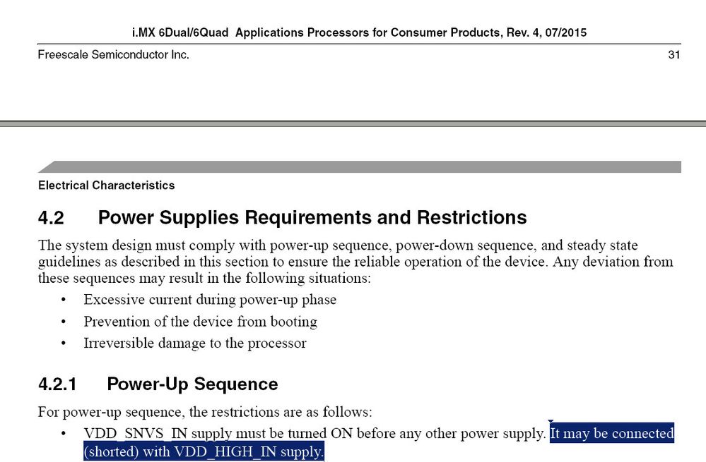

Then can we supply VDDHIGH_IN and VDD_SNVS_IN from the same source(SW4-3.15V) at the same time(at the very beginning)?
Nori Shinozaki
980 Views
igorpadykov
Hi Nori
right, datasheet provides such possibility
igor

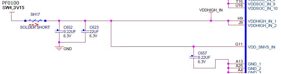

Do you suggest to provide current with VDDHIGH_IN and VDD_SNVS_IN separately as follow?
For VDDHIGH_IN:
For VDD_SNVS_IN:
Which is better do you think?
Nori Shinozaki

igorpadykov
Hi Nori
separate seems better as allows to provide better filtered
power for both VDD_SNVS_IN and VDDHIGH_IN.
igor
