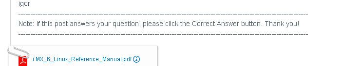

1990rahulreddy
Hi igor, There is no attachment. Please, attach files.
1,581件の閲覧回数
igorpadykov
Hi Rahul
attachment in red in above post, click on red with mouse.
